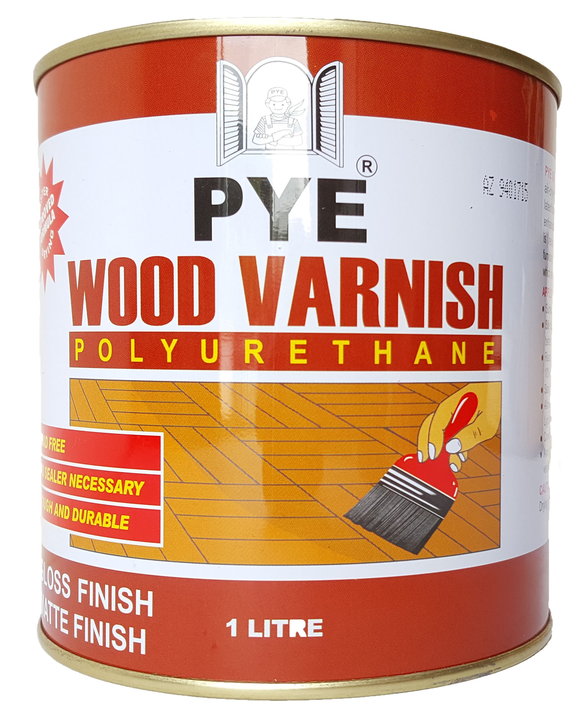

QUOTE(acbc @ Sep 6 2018, 11:29 AM)
If u want natural colour, just apply 2 coats of water based PU. Need to sand in between coats with 180 to 500 grit sandpaper.
where to get water based PU? I went to check Ace Hardware, all are oil based

Some ACE hardware has MINWAX water based PU. But the price rm160 per liter...
Another water based clear coat can buy from hardware store, forget the brand. Looks milky when wet then will clear up when dry. But still yellowish in color.
Later I go home take picture of the water based coat.

QUOTE(yushin @ Sep 12 2018, 04:47 PM)
Please do share, just in case my teak oil turn out bad, I can get a new solution haha

post Sep 14 2018, 10:05 AM
3,329 posts
From: Selangor
Nicora water based wood sheen.
http://www.nicora.com.my/v2/index.php/2013...-gold/woodsheen

Is depend what is the purpose and resistance you need too.
You can applied lemon oil or PU.
Most local hardware shop call PU as varnish. You can also burn the surface and sand it prior applied PU to bring out the grain.
PU will more water resistance but the surface will feel like acrylic compares to lemon oil.
This post has been edited by chamelion: Jan 5 2019, 11:16 PM

This wan will turn yellowish after some yrs. And not matt white like satin.

i have one can, still new, cos its gloss (not matt) so i didnt really use it, cos not a fan of gloss.
open inside is the color of yellow cooking oil fluid. biggrin.gif so i dont think you need years to make it yellow. biggrin.gif

lemon oil has zero protection. PU has very good protection against scratches
