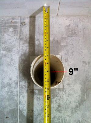

Here is a sample of how to measure S-trap
