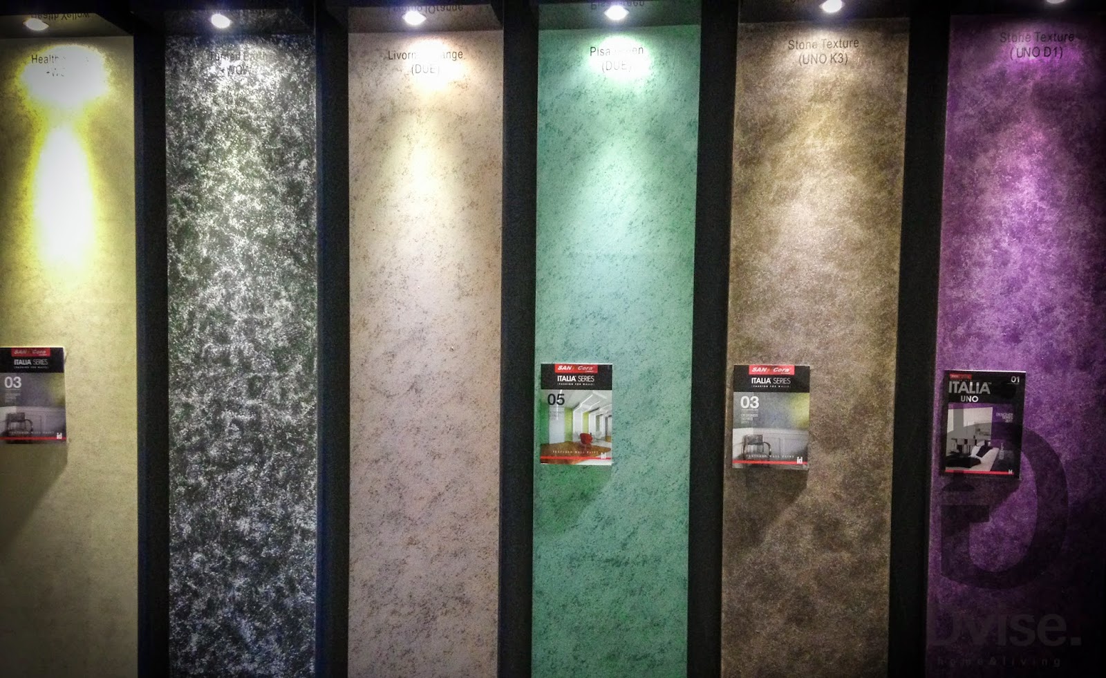

hi, what is the reason you applied 1 layer of perfect white before the primer? the perfect white is not part of the momento set right?
the primer is what color actually? usually primer to me means just a layer to make the next layer stick. but for momenta primer = base color?
momento is the pattern part of the paint? how long did you wait before drawing the pattern?
how much did that wall cost you to paint?
Well, primer is in white colour but IMO, 1 liter is not enough to cover the existing colour, so it's better to cover it off first. It's not the same as ordinary white paint, it has rough surface upon dried off.
Primer takes like 1 hour to dry, so you can only apply after that.
Momento is just a special paint with glittering powder or white putty like mine. You need to paint it using cross method to produce the pattern with the custom paint brush.
For my luxury series, it comes with some small lump of white putty in the blue paint. Paint it using cross "X" method then after 30min use a flat card (provided by them) to press the white putty to produce the special white effect.
For 1 set of 1 liter for both primer & base, it cost me RM110. I bought that during PSM (Meru) stock clearance. So total is like RM110 + my perfect white, probably RM150~200.

the manual says do X method or the person told you? i've seen some samples go by "Rainbow" curve, i'm wondering how they do that? most shown in shops have the X pattern but i not so fancy prefer smoother patterns.
btw are there Momento with less rough surface but can still do pattern just after finish painting the surface is only slightly rough but not very obvious?

if you want simple, try sancora, those are pretty straight forward to apply
This post has been edited by VeeJay: Jan 3 2018, 10:37 PM

looks not bad the 2 patterns on the right side. but really can achieve this patter?
is the texture rough or smooth after finish?
same like Nippon need 2 coats?
price wise compare to Momento how?
1st time heard this brand.
VeeJay
post Jan 4 2018, 12:10 AM
3,854 posts
Joined: Aug 2005
QUOTE(advocado @ Jan 3 2018, 11:20 PM)
yes pretty straight forward
smoother than other brands
first coat is the paint color of your choice...then
use the WOW finish to do the pattern (its like shinning glue, and uses normal painting brush provided with the purchase)
I did mine 2 years ago, cant remember. Bought it at Mr. Paint
Check with them when would the promotion comes, I bought half the price of momento
They are pretty famous, there are tons of signboard of them on north-south highway
This post has been edited by VeeJay: Jan 4 2018, 12:11 AM
