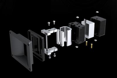

The structure of Air Pulse A200 Horn loaded Tweeter

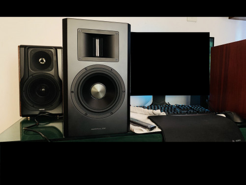

First A200 in town.

The A200 horn loaded tweeter is a true ribbon tweeter. It inherits the mechanism of the tweeter in our flagship 7001i near field monitor, but with an added phase correction device which greatly improves frequency response and increases sound dispersion.
A 65mm length and 0.12mm thick aluminum ribbon is placed between the two large neodymium magnets. Electric current feeds through the ribbon so that it functions like a coil in a conventional loudspeaker. At the same time, the ribbon also acts like a diaphragm as it moves air. The combination of these two functions gives the ribbon tweeter high efficiency and great transient response without delay.
The A200 ribbon tweeter has a very low resistance of about 0.2 Ohm and it works with a transformer. The primary coil of the transformer connects to the amplifier; the secondary coil connects to the ribbon and it is wound of very thick and flat copper wire. The low resistance brings more current through the ribbon thus rise the SPL of high frequency, which leads to wide frequency response.
We construct the A200 tweeter with the highest quality aluminum ribbon, strong Neodymium-Rare Earth magnets material coupled with an appropriate transformer to give it high sensitivity, superb transient response, extended frequency range and ultra high definition.
The unique shape and size of the horn on the A200 tweeter was designed from precision calculation and simulation. Connecting the ribbon tweeter to a horn helps the sound generated by ribbon better coupled to the air. It further increased efficiency, power handling, frequency response and dispersion.
A wide frequency range and good transient response is vital for the reproduction of the dynamics of music such as what you hear in the musical density of symphonic music or jazz ensembles.
The horn loaded ribbon tweeter of A200 offers just the right features: high sensitivity, good transient response, wide frequency band, high resolution. You can now hear every nuance in the music, and enjoy it to the fullest extend.

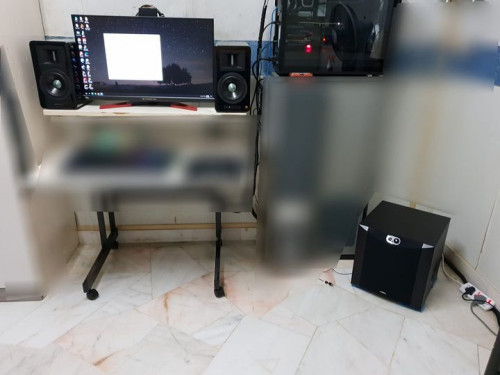

Subwoofer? What model?
TSEdifier
post Jul 28 2020, 10:53 AM
Store Representative
9,164 posts
From: Edifier, Stax, Noctua and AirPulse
QUOTE(Levin92 @ Jul 24 2020, 11:45 PM)
ASW-300.
Levin92
post Jul 29 2020, 03:28 PM
61 posts
Joined: Sep 2006
QUOTE(Edifier @ Jul 28 2020, 10:53 AM)
ASW-300.
Interesting... But unable to get the info/spec.. When it will launch? Price range?
TSEdifier
post Jul 29 2020, 08:50 PM
9,164 posts
QUOTE(Levin92 @ Jul 29 2020, 03:28 PM)
Still under development, 10 inch and around 300w RMS.

hey bro, i bought airpulse A100 already and a Yamaha 10 inch subwoofer model NS-SW300 (rm1400), the sound is very great very matching crossover slope!
at the subwoofer High-cut i set to 70hz and volume knob at about 10:30 o'clock position.
if can don't get 12 inch sub for these A100 speakers might have a sound hole or over powered it because A100 i tested in my room (my room is small about 6 x 8 meters) and i do a bass frequency sweep test, about 80hz start and below the A100 bass starts to drop already, listening by ears, but it also depends on your listening position because my position is middle of room, if ur listening position is at the end of the wall then it is very audible bass even around 70hz it will be shallow but audible....
i simply use this youtube sample for bass sweep test
https://www.youtube.com/watch?v=LJ6Hc3zH5KE
even though the specs written is 52hz - 40khz but in real scenario for my case my room listening it starts about 75hz and bove is more audible (can feel the sound), and my subwoofer starts to kick in louder around 83hz and below, by my ears listening close...... i believe my room is consider very small already if your room is bigger A100 gonna be more loud audible maybe around 80hz and above (mileage might be vary depends on your listening position and subwoofer placement).
i set all the volume is very balance almost can't feel the subwoofer is there when listening music but can feels the vibrations overall from my seats, it feels like the bass is coming out from the both channel of the A100, i prefer like this, if volume up the sub abit higher can feel too much bass coming from that subwoofer direction covering the A100 speakers.
This post has been edited by djandrew: Sep 25 2020, 12:51 PM

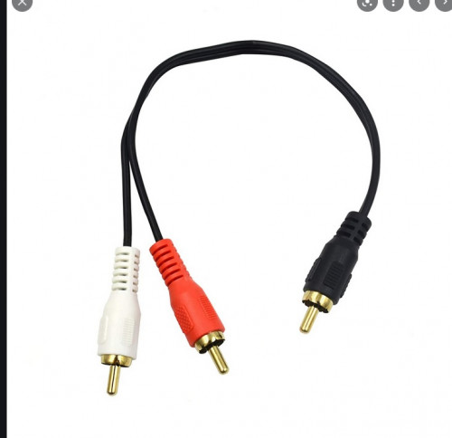

You can but the only way I know how to involves sacrificing the bluetooth and volume control function of the speaker and it only works with RCA inputs
If you're saying you wanna use KEF Kube b12 then you'll need
- a method to control volume for both speaker and sub (It could be a TV remote volume, PC volume, or an external DAC with volume control)
- two RCA Y-splitter to split your signal to your edifier and your subwoofer
Here's a rough image I found online on how it's connected
That way you set both speaker and subwoofer volume to blend up to your taste, leave the volume setting and use your source as master volume to control both simultaneously.
I would recommend Edifier's own T5 subwoofer instead for a low budget sub since it has an RCA line out included so you can skip the y split and use the subwoofer line out instead as the splitter.
You will still need a way to control volume for both sub and speaker

QUOTE(alexloon @ Nov 21 2020, 05:18 PM)
How do you feel the difference on treble and female voice for both? Since 1 is using planar while another is ribbon.
For bass I assume you mean both sound the same? But A100 need some placement fine tune to get the same bass? If just put same place to S3000pro, how does A100 bass sound like?
alexloon
post Nov 21 2020, 09:18 PM
100 posts
Personally i do prefer A100 female vocal voice because it well refine.
S3000pro seems easier for me to position it and the bass definitely bigger and exciting than A100, as for A100 i did place nearer to the wall to get tighter wider bass. First i wish they're same but 5" and 6.5" seems like not logical... hahaha
l actually love both of them and A100 have very clean sound and the design i like.
QUOTE(xxboxx @ Nov 21 2020, 07:51 PM)

same A100 owner here been using for months, with add on yamaha 10 inch subwoofer, A100 sound really transparent clean and clear. im using with pc sound card (creative AE-5 sound card) through the RCA connector, if use optical vs rca for my case the rca sound way more better. hmm.gif
yeah the positioning of this speaker really makes a big difference to the sound tho (back wall side wall etc) especially the bass differences.

hi there,
noob here. new user edifier airpluse A100
Is this the cable to connect airpulse A100 sub out to edifier t5 rca?
the cable it is called it as RCA male to RCA 2 male?
It does look same RCA port. I think it got 2 RCA for in case using stereo output. Yo can try just use any 1 RCA from A100 to T5.

RM2299 + rm459 from shopee. installment . But if use lazada more get discount from lazada bonus minus RM3xx
yesterday just bought the Pro Av Y-Cinch Subwoofer Cable cost me about RM280

The SM200 loudspeaker from AIRPULSE features its unique "horn-loaded ribbon tweeter", based on the company's original 7001 speaker design. The tweeter utilizes an ultra-thin, pure aluminum ribbon diaphragm, with a thickness of only 0.0005 inches, or 0.0127 millimeters. This delicate ribbon, for comparison, is about 10 times finer than the average diameter of a human hair, which is approximately 0.1 millimeter.
The ribbon functions as both the voice-coil and the diaphragm in this tweeter, generating sound waves by vibrating in an extremely high magnetic flux created by Neodymium Iron Boron magnets on either side. This high-precision design delivers high sensitivity, superior transient response, wide frequency extension, and excellent resolution. The result is a rich and faithful reproduction of all details in the sound.
The unique horn-shaped design optimizes dispersion. Sound reaches the audience directly, reducing the impact of environmental interference, making the sound image more three-dimensional, clearer, and more natural, truthfully reproducing the content of the recording without any loss.
