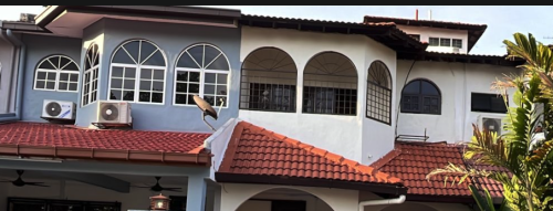

If I were to extend a bit of the front part roof (from right side house to be like left side house), does that need CCC from MPSJ? if yes, what's the approx costs?
