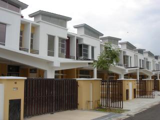

I'm writing this for my second home, and I'll share what I've learned the hard-way!
PS: Mods I'm reserving a few posts for the remainder of this article and some pictures I hope it's all right!

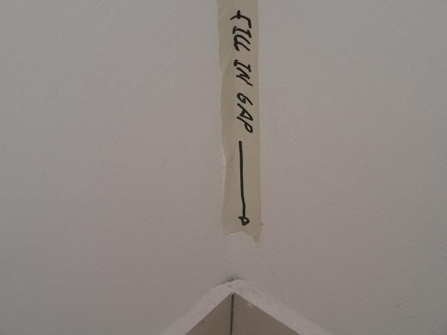

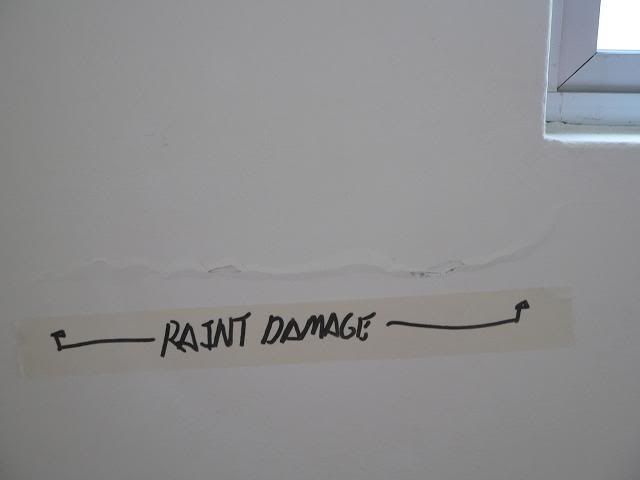

I) Marker Pen & Masking Tape

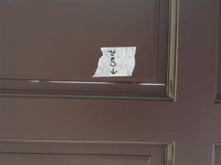

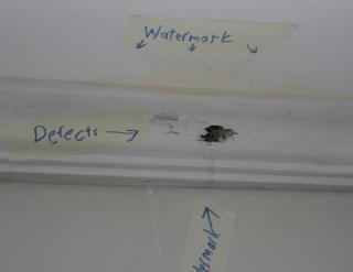

Use the Marker Pen and Masking Tape to mark out areas of concern so that contractors doing rectification work can easily spot trouble areas.
It helps because it's mystifying to figure out where the defects are from the description on the defect list to an actual flaw on the house.
You can also scribble notes and express your displeasure on the masking tape so there is no miscommunication. smile.gif

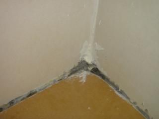

1) The Walls & Ceilings
I'm referring to all Wall and Ceiling surfaces.
I) Cracks, Wavy and Uneven Surface.
It's pretty common and you should be able to see it quite easily.

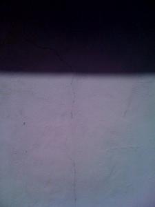

Cracks on the Walls
Sorry no pictures of uneven or wavy surfaces it was impossible to get it to show up in pictures.

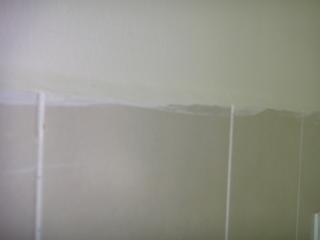

II) Holes and Chips.
Holes and Chips on walls and ceilings are also another common defect and can occur due to accidental knocks and bumps or poor quality of materials used.
Chips Everywhere around the Staircase Area
Missing Plaster

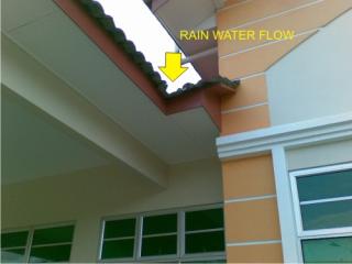

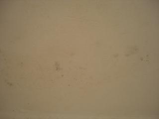

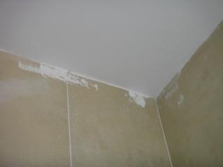

III) Fungus and Water Marks.
It can happen due to piping leakage or roofing defects. On the top floor the ceiling is covered in ceiling boards make sure the boards are not damaged or dirty.
Fungus & Water Damage
More Water Damage

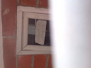

Lumps & Bubbles, Flaky Paint, Protruding Objects:- like nails, stray pipes, loose wiring & iron rods sticking out of walls and ceilings.
Exposed Metal Rod

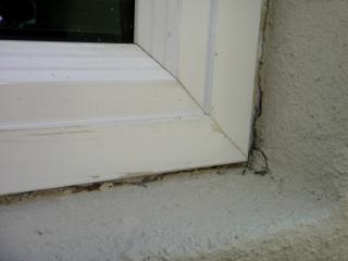

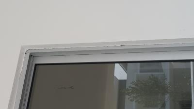

Window Frame Covered in Cement
Poor Paint Job

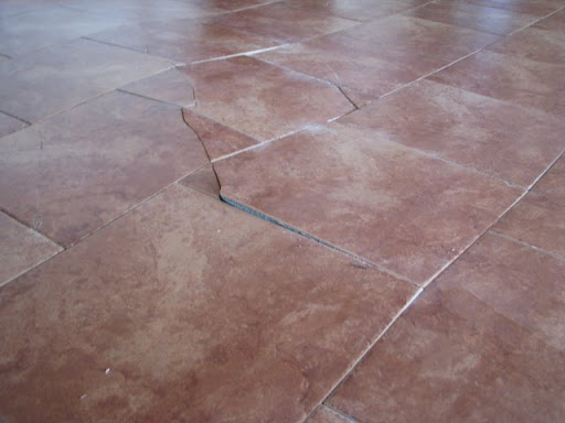

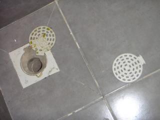

2) Tiles & Floor
The Tiles & Floor include kitchen, bedroom, bathroom, floor tiles and cornices.

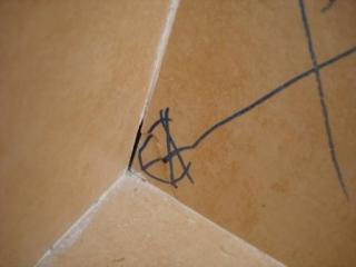

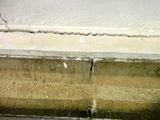

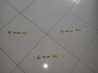

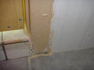

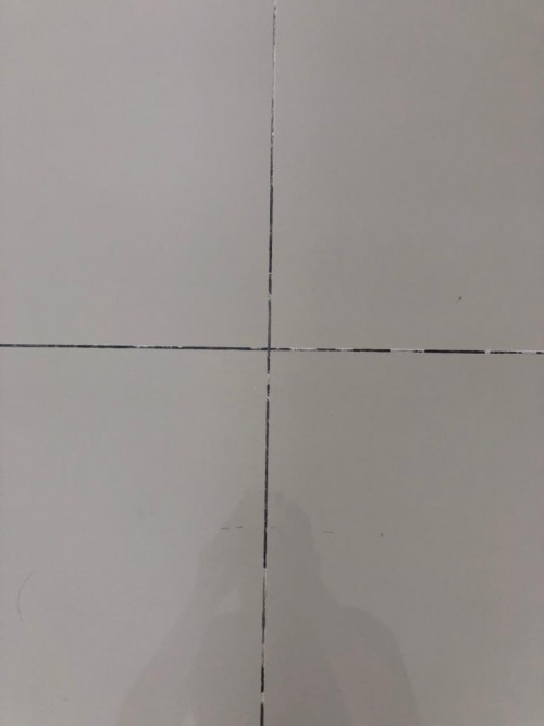

Tiles - Missing/Cracked/Chipped/Slanting
Missing and damaged Tiles & Floor are easy to spot for defects. However it's not easy to check for hollow tiles which are due too little plaster underneath.

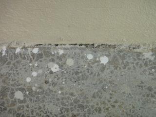

The danger is the tiles can come off or crack if not remedied. Tap on tiles and if they sound hollow mark it out as a defect anyway and get the contractor to fix it.
Also make sure that the joints between the tiles are properly filled in with plaster. If you notice deep gaps make sure they fill it in.

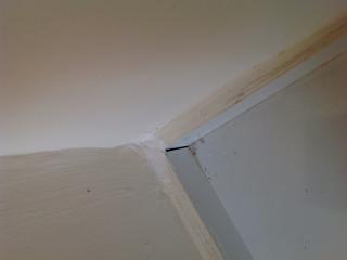

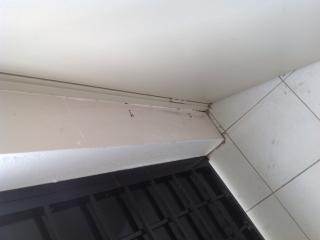

Gaps in the Wall Skirting
Not many other defects on the tiles everything is fine as far as I can tell!

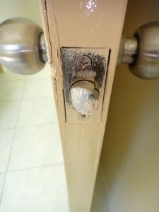

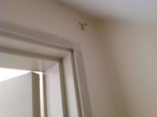

3) Doors & Windows
Doors and Windows are fairly easy to check. Ensure that doors and windows easily open and unobstructed. Check for shoddy workmanship like missing screws, damage and rust.
Also ensure that everything is properly installed and there are no large gaps between the door and window frames. It's also a good time to check for water damage since windows not properly installed will leak during heavy downpour.
Check also that rubber seals for the windows are intact.

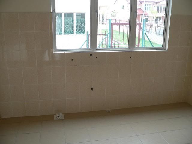

4) Miscellaneous Fixtures
Check the developer's inventory list for missing fixtures and accessories. You'll usually get a list of items that come with your home such as the number of electrical points, taps, sink, shower heads and etc.
Check the list thoroughly and make sure nothing is missing!
BEFORE:
AFTER:
Yup the sink was missing tongue.gif so was the wiring, seems some gawd damn thief carted away those items from our finished unit.

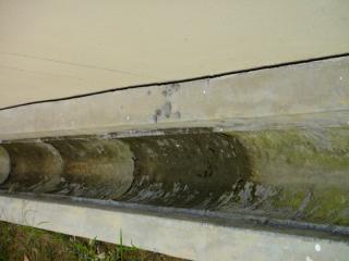

5) Leaking Pipes
Leaking Pipes are also easy to detect, check the exposed piping for leaks or walls where the pipes run through for water stains.
Query the developer on where the pipes in your unit are; in future it will help to prevent accidents due to accidental nailing or drilling. You don't want to hang a picture frame and puncture a pipe all in one go. tongue.gif

AAron.. wheres the house, looks interesting.. Im looking for a double storey link also.
Click this link for more details...
Basically it's Taman Puchong Utama Phase 10B!
Why don't you mention where is the location you're interested in and the budget you have?
Happy hunting and I hope this post would be useful when you got your own home sweet home thumbup.gif

Btw, looking at the cracks on the wall, how do u think the contractor will help to solve the problem? AFAIK, the houses are build from sand bricks, not clay bricks. So u got to becareful not to nail anything on the wall coz it will just puncture and damage the wall.
The cracks and defects the developer will repair because the house is still covered by the defect liability period which is 18month. biggrin.gif
Most likely they will cover it up with more plaster and paint it over. Clay bricks are expensive moneyflies.gif

drawing from experience, it is a good practice for buyers to inspect the house personally, preferrably with the construction drawings approved by the architect(s) in hand the whole time. problems highlighted by aaron in this topic are mostly superficial, although it does make ur house look "cheaper" than what u've spent.
however, it is my experience that contractors sometimes could make such a huge error, for example, missing a floor beam! before applying for CF, usually architects will do a thorough inspection of each and every house in the development. but inspecting 500 houses in a week can be tiring, and even architects can miss such errors.
and do take extra care on "cracks". there are several types of cracks, most commonly are plaster cracks, which is virtually small matter and can just be patched with fillas and painted over. other cracks can be structural, which something u must pay attention to. it's very hard to differentiate even for the experienced.
