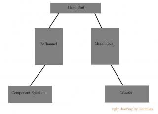

This is roughly how basic ICE worls.. i hope that this can b pinned up so that beginners can get a picture how it is normally run..

can label which kind of wire used to connect every single item as well??
TSmattchin
post Sep 25 2006, 12:33 PM
!ga0 ga0 lik!
1,645 posts
From: aMPanG, KL
fren...
it's either RCA o speaker cable.. if it is speaker cable then it is for speaker.. and RCA is used between the crossover, amp and HU smile.gif

can jus use one monobloc to kick two 12 woofer bcz u can bridge the woofer together, jz check dereturner diagram....
tohsan,my setup is jz like the drawing,simple....
