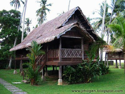

QUOTE(call me random @ Nov 18 2014, 10:13 PM)
+1
summore would prefer the container to be raised up as much as 1 feet above the ground level.
that sound like this

QUOTE(ohman @ Nov 18 2014, 10:18 PM)
itu 6' bai
bukan 1'

QUOTE(even_steven @ Nov 18 2014, 10:42 PM)
Tak boleh ganti dgn atap nipah ke?
boleh. but the gaji to pay makcik and nenenk to weave the atap nipah is more expensive than just buying metal roof sheets

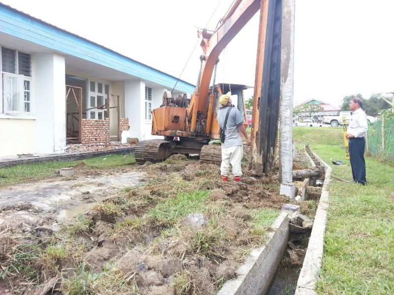

QUOTE(paskal @ Nov 20 2014, 09:47 AM)
waiting for the monsoon season to pass. just nice to let the piling to set in this weather.
first time i see people use weather to set the pile
usually we just drive the pile to set, either by skin friction or to hard rock layer

QUOTE(lucifah @ Nov 20 2014, 10:03 AM)
it's better to pile after monsoon i think, is it?

QUOTE(azreeceli @ Nov 20 2014, 10:15 AM)
LOL
it doesn't matter when you drive the pile, as long as not during the rain as the hazard of the pile slip and fall is high when it is wet / raining
if you do piling during monsoon, the soil will get soggy and the it will be difficult to move the piling rig around to all the piling points
i didn't use the weather to set the pile. it's just that the weather isn't conducive to start building.
so might as well pile before monsoon and leave it to rest through the not-so-favorable weather. make sense?
i'm depending on friction to hold the structure. as the soil underneath the plot is quite soft because it's an agriculture land. so like it or not we need to let it set. would you rather let it set through dry season when it's best to work with cement or let it set through monsoon season when it rains heavily everyday?
after monsoon there's gonna be a few month of dry season, esp during march. that time is good to start construction as there's very little rain and the weather is very predictable.
if you're opting for friction to hold the pile, you need to let it rest. so you could pile before the monsoon starts, let it set through the monsoon and start construction after the rainy season passed.
