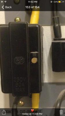

As per attached, my house's meter adapter (I saw the appointed electrician by the developer installed it during the commissioning of the electricity to my unit). Now it is gone. How much does this thing cost?
The meter is installed right at the pillar and locked (and of course can be unlocked easily).

Think 10 or less. I brought one before. Your is 40 or 63amps?

63A... So it can be bought from the market easily?

I saw 63A at the DB box so I assume that one is 63A? What is it called? I think I will report to the developer handover office to give them alarm on the theft... I seriously dont think TNB will need to remove this. I saw tampered key hole mark...

Pretty common thing. Can get at any electrical shop. Just snap a picture and show it to the shop.

1 side of the copper contact is LIVE. So becarfull not to touch it.
If your hand shaking, than pay some fee for the shop guy to help you.

This is called 63A cutout fuse(common electrician term). I think your brand is PLK, which is approved by TNB. These things get stolen all the time. There is copper inside, so thieves will just sell as scrap. But get the developer to replace one since still under 1yr.

May I know where I can actually find it? I went to a few shops and all of them are selling old type big one... Mine is measured at 8cm x 4cm... Eventually I went to TNB and reported for the missing fuse.

Yo bro, so you can confirm the brand is PLK, slim one measured at 8.4cm x 4cm (holder dimension, so the fuse should be smaller a bit).

I juz called n asked. I was advised to change everything include the holder as the dimension maybe a little bigger?

The attached is from my neighbouring unit.

Just buy change the casing if need too. When I change, some shop told me got 3 to 5 types, i brought the two most identical, lucky one it match.

QUOTE(sw.boutique @ Oct 14 2013, 05:46 PM)

Anyone please tell me where can i get this type of fuse. Specific name of the shop please. I live in pj btw. Attached Image
This post has been edited by Fznsr: Feb 20 2016, 12:28 AM
Richard
post Feb 20 2016, 01:02 AM
1,083 posts
From: Kota Kinabalu
You buy it at an electrical shop..
Its called a 60A cut out fuse and holder.. or 60A/100A as they're the same dimensions
Inside should be is a HRC (high rupture capacity slow blow) ceramic fuse with a fixed or replaceable fusible link. That's the name for the fuse wire..
You'll need to brace yourself so you don't fall when you pull it out (or push it in) as the connectors are spring loaded to maintain a very tight fit.
