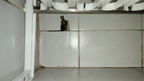

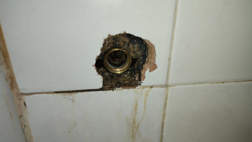

Hi this is the picture of my stop cock. It is below my kitchen sink.
QUOTE(cchean @ Oct 25 2021, 11:28 AM)
As the pipes are concealed, i've requested the plumber to re-pipe (external) from main to my water tank to bypass the internal pipes. After repiping, the stop cork area is still leaking water after 3 days.
I was thinking it could be residue water in the internal pipes that haven't cleared, but it seems to be still leaking after 3 days. Anyone has similar experience and how you resolved it?
I read your post again ...
If you repipe to the reserve tank only, where did the water to the sink come from ?
The plumber did a new piping for the sink area ? If yes, then it shouldnt have water in the old piping. All water to sink are from the main.

QUOTE(mini orchard @ Oct 26 2021, 01:07 PM)
Hi Mini Orchard,
For the water to my kitchen sink it is from the roof. My kitchen is at the back of the house. So there is a new external pipe from the roof which connects back from the back of the house to my kitchen to supply the water to my sink. Yes, you are right, there shouldn't be water in the old pipe. I am still trying to figure out the issue.

QUOTE(cchean @ Oct 26 2021, 10:51 AM)
If close the stop cock, will the water keep coming out?

QUOTE(cchean @ Oct 26 2021, 02:19 PM)
Hi Mini Orchard,
Then remove the stopcock using a spanner to see whether there is any water flowing out.
If the old piping is from the main, then it shouldnt have water. Otherwise, the piping could be from the reserve tank and it also leads to the bathroom.

QUOTE(Noryume @ Oct 26 2021, 02:28 PM)
When i close the stop cock, water still flows out.

cchean
post Nov 2 2021, 10:08 AM
176 posts
Joined: Apr 2013

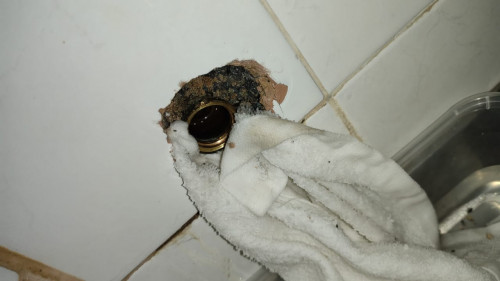

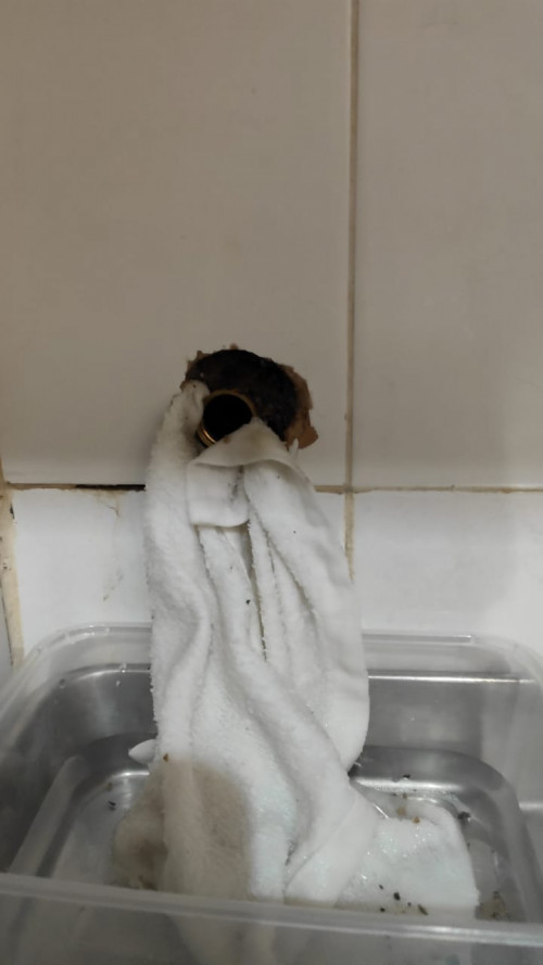

I've removed the stop cock and there seems to be no water coming out of the pipe. But there are water seeping out from the surrounding surface of the pipe. I'm just thinking now it could be a leak from the neighbour as I am living in a double storey terrace house and share the same wall with a neighbour.
hsunl
post Nov 2 2021, 10:10 AM
146 posts
Joined: Aug 2010
From: Seremban
Yes. Quite high possibility
hsunl
post Nov 2 2021, 10:13 AM
146 posts
Joined: Aug 2010
From: Seremban
Luckily u r not doing any cabinet to cover up the stopcock area or else u won't be able to see any leaking

QUOTE(hsunl @ Nov 2 2021, 10:13 AM)
Yes i agree, with this experience, quite fearful of concealed pipes now. Once there is problem, it can be a nightmare.

cchean
post Nov 3 2021, 05:17 PM
176 posts
Joined: Apr 2013
I requested my neighbour to switch off the main supply for his house. After one night, the leaking stopped. The leak is coming from my neighbour. Moreover, my neighbour's house is slightly higher than mine.
mini orchard
post Nov 3 2021, 06:48 PM
10k Club
14,511 posts
Joined: Sep 2017
QUOTE(cchean @ Nov 3 2021, 05:17 PM)
So your neighbour should do repiping and not you. Leaking should be check thoroughly b4 doing, otherwise is waste of money. Even have to break some tiles, I will do it.

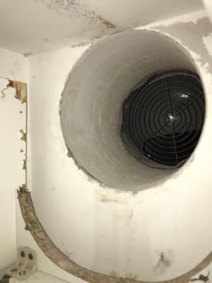

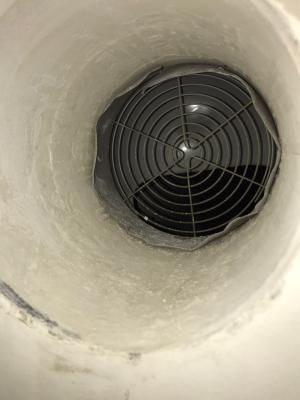

Hello sifus,
I am having a problem with rainwater leaking into the kitchen, during heavy rain.
First time home owner. Condo. Had coring done for kitchen hood.
At first suspected it's the windows silicone and got it fixed. When it rained again, water started to seep in and collected at the kitchen floor.
Suspected the exhaust outlet (coring) and found out the wall is wet. The water must have seeped through the exhaust fan and through the wall until it gets into the kitchen.
Is there any way to fix this problem? Sooner or later the water will damage the kitchen cabinet cry.gif Any suggestions to fix this? Thank you in advance.
Attached Image Attached Image
mini orchard
post Mar 6 2022, 09:47 PM
10k Club
14,511 posts
Joined: Sep 2017
QUOTE(mnky @ Mar 6 2022, 05:59 PM)
Hello sifus,
Take a wider photo of the area. Nothing much to see now. Include both indoor and outdoor view.
Hello sifus,
If due to the heavy splash of the rain, normally you will need some sort of louver at the external to prevent the rain water from splashing into the cored hole. The better way will be coring the exhaust hole slightly slanted to the external, the slant / gradient will allow any water coming in to be drained out via gravity.
