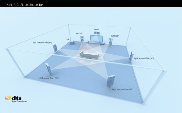

FYI:
Note: The bitrate indicated are the most commonly found, while they can actually be higher.
Horny, your setting is correct, just make sure you're listening preset for DTS-HD MA as DTS-HD MA, and so on. The Panny BD30 can bitstream high-bitrate audio, so no problem there.

post Sep 23 2008, 11:00 AM
hmm...
4,865 posts
Joined: Mar 2008
myqd
post Sep 23 2008, 11:42 AM
2,247 posts
Joined: Feb 2005

fentanyl
post Sep 24 2008, 09:40 AM
478 posts
Joined: Apr 2005
QUOTE(mikapoh @ Sep 24 2008, 09:38 AM)
Hey guys,
What is DTS HD of 7.1 speakers set-up ?? Do I need 2 pairs of surround speakers ? What are the effects ?
Also, do I need a HD support AVR to enjoy this 7.1 effect ?
Please advise, thanks.

mikapoh
post Sep 24 2008, 03:10 PM
1,263 posts
Joined: Aug 2008
From: Kuching, Sarawak.
QUOTE(fentanyl @ Sep 24 2008, 09:40 AM)
Thanks a thousand times for the picture which describe everything.
Few questions arise:
1) That 7.1 set up seems applicable for a spacious room. What about if you have normal size terrace house living room where your seating position is next to the rear wall ?? For 5.1 set up the 2 rear speakers are facing other, then where to out additional 2 rears for 7.1 set up?
2) Why 4 rear speakers and not front 4 and 2 rears instead ??
Please help to posion me into BD world one day !!!
