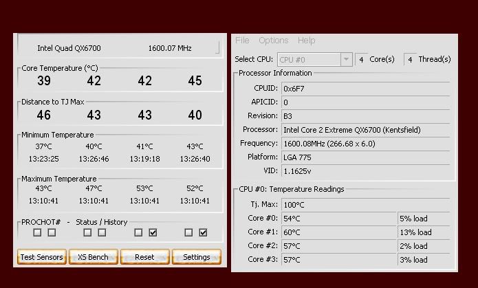

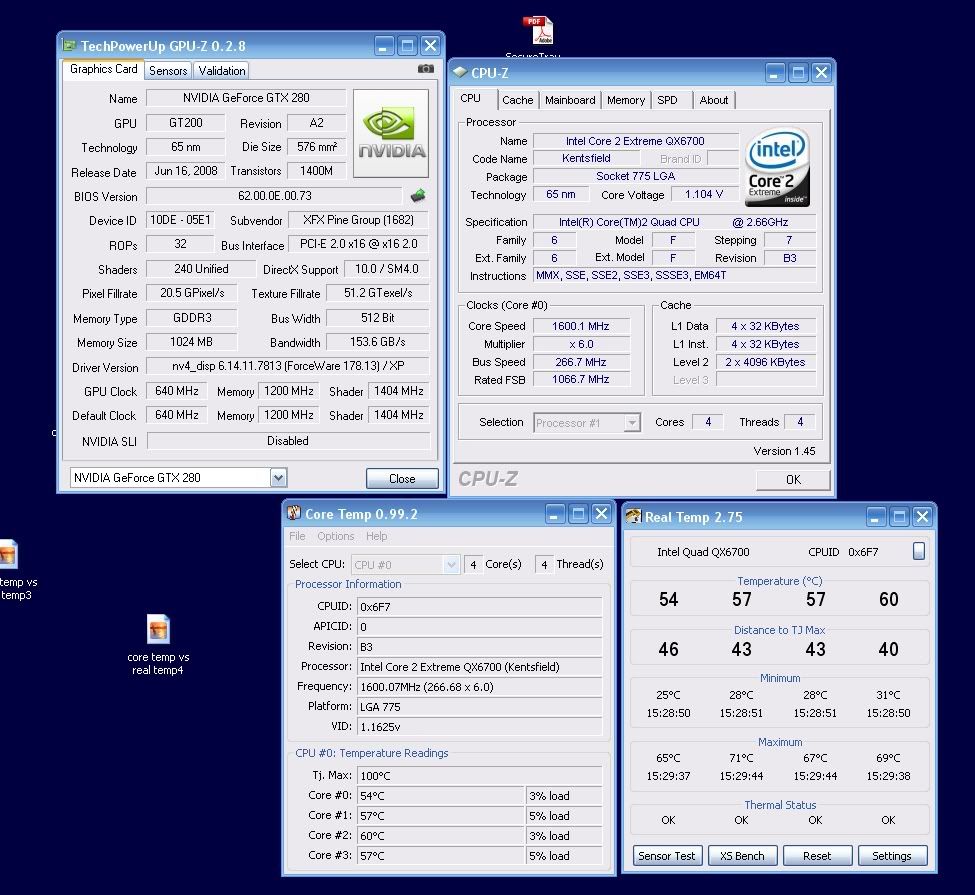

post Oct 12 2008, 01:36 PM
27 posts
Joined: Oct 2008
QUOTE(-pWs- @ Oct 12 2008, 01:23 PM)
Post screenie here w those monitoring softwares.
-pWs-
i i sir..
and for information.. i m seting at bios, temp sound warning at 60 c
and i dont hear any sound
i m happy with this result..

what mobo u were using anyway?sometimes mothbroard sensor are inaccurate too.like mine
gigabyte x48 dq6

urusnet
post Oct 12 2008, 01:52 PM
27 posts
Joined: Oct 2008
QUOTE(syahirax @ Oct 12 2008, 01:47 PM)
maybe bro.. got to learn this.. maybe the sensor wrong
qx6700
x48 dq6
croshair 2gb x 2 800mhz
gtx 280
odin 800 watt
scorpion xigmantex
p80r

latest core temp and latest real temp
i m uninstaling my window blind
This post has been edited by urusnet: Oct 12 2008, 02:01 PM

QUOTE(hilmiangah @ Oct 12 2008, 02:11 PM)
50'c++ on idle.......
u better get a better cooling system or go water cooling.
its normal temps for 65nm quad + its B3 steppings.... its hotter then G0 of course....
even on watercooling also hard to tame those B3s

QUOTE(Ryo @ May 15 2008, 03:06 AM)
so yea as the title says...which software gives the most accurate reading of a proc's temp?
Core Temp or RealTemp?
both can give same result...
both detector must set same Tjmax..
thanks all bro here.. luv u all.. i learn something new today..
