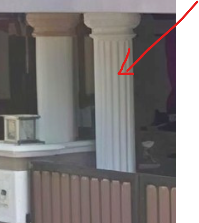

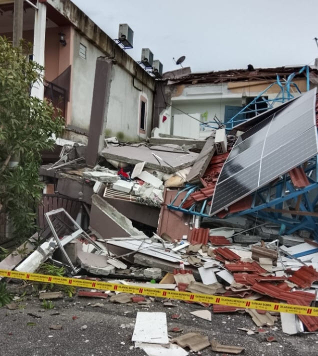

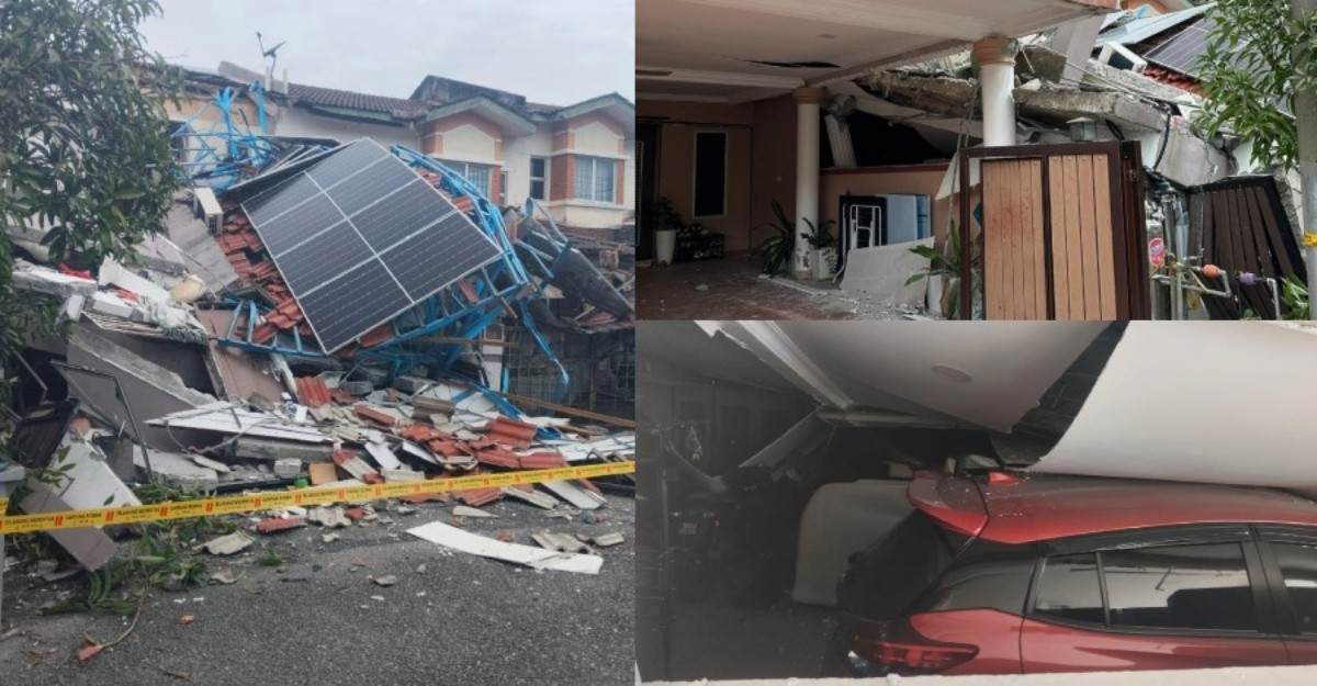

QUOTE(netmatrix @ Dec 18 2025, 04:49 PM)
Old house maybe 50 years? Use wooden trusses. They add heavy solar panel. Wood rot and then break.
blue alu truss la, see picture

QUOTE(ycs @ Dec 18 2025, 04:55 PM)
Ok if that is so, then must be build by cheap ass no name renovation company.

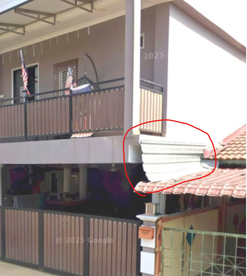

QUOTE(andrekua2 @ Dec 18 2025, 04:48 PM)
Next door baru 1 floor... most probably developer build 1 tingkat...these guys no piling but build another floor on top...
no lah whole row is double storey house, this house go extend the car porch area and build 2 storey extension on it.
Most likely the owner didn't do foundation piling to support 2 storeys, just cincai add beam on it and do slab on it, look at the weight the beam has to withstand with the solar panel, cement floor slab and metal truss roof

QUOTE(yhtan @ Dec 18 2025, 04:58 PM)
https://www.tiktok.com/@utusantvofficial/vi...106834026007828
depan is nothing, just car porch... got piling? house still intact what...

QUOTE(andrekua2 @ Dec 18 2025, 05:01 PM)
the one intact is original house built by developer, the one collapse is renovation extension, look at the neighbour house and u can see the vast difference
I guess 99% tarak piling on the extension part, if not the beam will be able to support 2 storey weight. Last time my house mau renovate and extend to double storey, the contractor macam dig about 3-5 feet (can't remember correctly) to build footing and column.

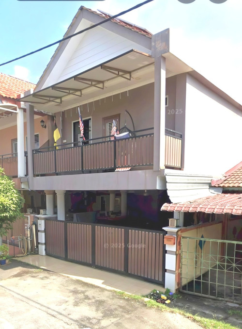

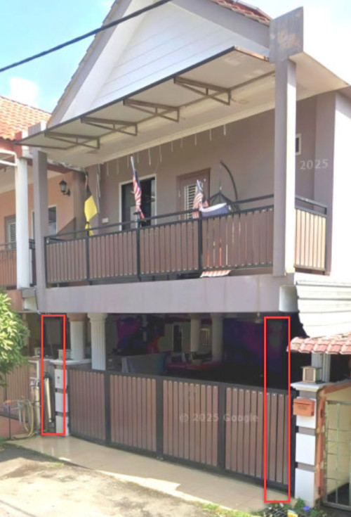

post Yesterday, 05:17 PM
112 posts
Joined: Jun 2019
Before pic
ycs
MEMBER
4,239 posts
From: Selangor
got peti ais besar
max_cavalera

QUOTE(Hardcore Leveling Warrior @ Dec 18 2025, 05:17 PM)
Before pic
Location mana bro? Isn't this the neighbour house?

QUOTE(Hardcore Leveling Warrior @ Dec 18 2025, 06:17 PM)
Before pic
post Yesterday, 05:21 PM
112 posts
Joined: Jun 2019
QUOTE(dest9116 @ Dec 18 2025, 05:19 PM)
Taman Pinggiran Senawang.
this is the runtuh house picture in 2024. the neighbour house can see beside it.
ycs
post Yesterday, 05:22 PM
MEMBER
4,239 posts
From: Selangor
front too heavy?
LazadaGot

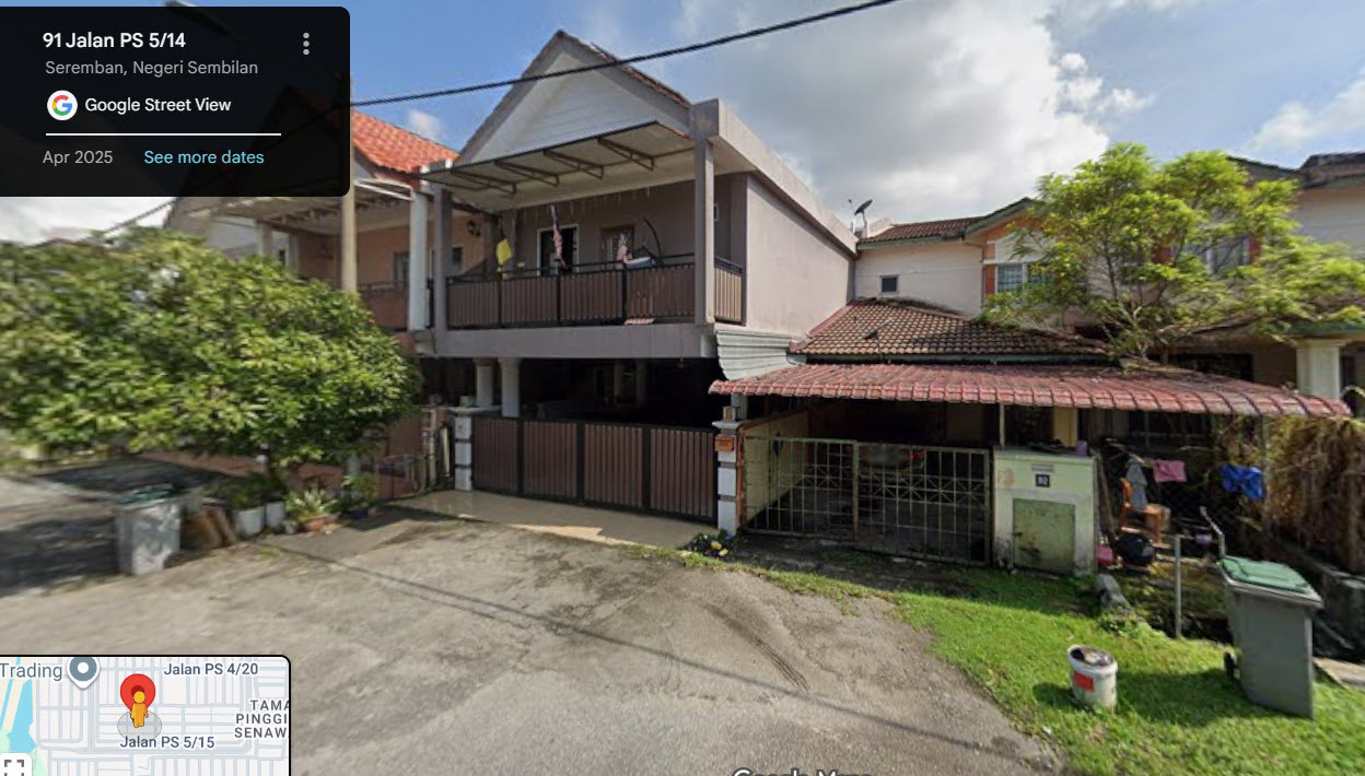

https://www.google.com/maps/place/94,+Jalan...5MjA2OUgBUAM%3D

QUOTE(Hardcore Leveling Warrior @ Dec 18 2025, 05:21 PM)
Ya I know, but jalan apa? The taman big bro
chinteck79

QUOTE(dest9116 @ Dec 18 2025, 05:23 PM)
Jalan PS 5/14

front too heavy?
Before pic
this kind of reno definitely illegal. where can extend up to front gate. both house also illegal. probably the runtuh one use cheapskate contractor
post Yesterday, 05:31 PM
112 posts
Joined: Jun 2019
QUOTE(chinteck79 @ Dec 18 2025, 05:26 PM)
if you check the whole taman, got many other houses having the same kind of renovation. GG.

QUOTE(awol @ Dec 18 2025, 04:46 PM)
solar panel?
Actually solar panel quite light
Before pic
Look at the front 2 column, most likely has no piling or footing to support the weight, once there is soil movement beneath the column will move and whole thing will collapse. I suspect the drainage which water seep into soil and cause soil movement.
For housing developer normally they do piling on the build up area including car porch, this one high chances didn't do piling on the extension.

QUOTE(ycs @ Dec 18 2025, 05:22 PM)
front too heavy?
Haha. That kind of tiang, I doubt it’s design to bear the load of 2 storey extension. If just for porch roof probably can handle lah.
solar panel?
Cannot be solar panel, I don't think so.
They just install on top of existing roof tiling, I never hear/see runtuh... 😁

I am guessing blindly:
1. No foundational piling;
2. Roof structure is old wooden;
3. Solar panel.

QUOTE(yhtan @ Dec 18 2025, 05:47 PM)
apa salahan developer on this illegal renovation?
Agree.
I suspect the right front column gave way first, then the left front column.
In the pics, the front columns cannot see, mcm topple, crushed...

He is using this prefabricated roman column, most likely not reinforced concrete and no rebar inside.

See old house pic also can guess what went wrong.
The other 2 neighbors must pray hard didnt share same contractors.
Else might be counting days.
Before pic
You see the round pillars, are those RC columns or decorative GFRC and infill posts?

QUOTE(jibpek @ Dec 18 2025, 07:13 PM)
Maybe inside got leh..
jibpek
post Yesterday, 08:03 PM
708 posts
Joined: Jul 2012
QUOTE(katijar @ Dec 18 2025, 07:59 PM)
I have seen many hollow one, never see any with rebar.
If there is, I guess the rebar will be extended so that it can be connected to the beam or ground beam. Just like those pre-cast pillar.

this one confirm no piling or very less piling both floor and wall doh.gif they think cement kasi glue enuff laugh.gif laugh.gif

post Today, 10:21 AM
9,050 posts
The supporting columns looked too thin and probably underspec.
Imagine having a heavy slab supported by 2 thin columns.
By right it should be thicker or added more columns for support. The house was top heavy to begin with.

QUOTE(jibpek @ Dec 18 2025, 08:03 PM)
roman pillar memang hollow. nak pasang kena ada tapak, buat rebar, tuang concrete

QUOTE(acbc @ Dec 19 2025, 10:21 AM)
Could be beam problems also

Joined: Jul 2024
soil movement shifted the right pillar base, moving the weight bearing pillar and collapsing the structure above. The left pillar was partially supported by the neighbours extension, therefore stronger than the right.
you can see the rubble all collapsed to a single area, where the right pillar is. If is was pillar structural failure (ie no rebar etc etc) it would have collapsed early on, not after years

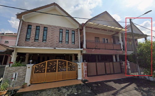

QUOTE(WhatMan @ Dec 18 2025, 06:43 PM)
So if the one on the right runtuh, what is to say the other 2 with extra extension.
tbh all 3 houses the upper part they extend until like that, damn fcking ugly lol

QUOTE(garion @ Dec 19 2025, 10:42 AM)
The original house did not have that extension. Perhaps he installed a toilet in a poor location, adding extra weight until the structure could no longer withstand it. If the beams and columns were constructed correctly, collapse would be unlikely. The nepal workers probably focused on finishing the job, it is uncertain whether the materials were used adequately.

beam not tied to the original house?
They don't care much about the look of the house as long as got extra room to accommodate family members.
Its not like the house around there look any better anyway.
Taikor.Taikun
post Today, 12:33 PM
1,019 posts
Joined: Sep 2018
Front part of the house extend lah, so that extra room on top of the car porch.
Cincai find Indon contractor like this lah
