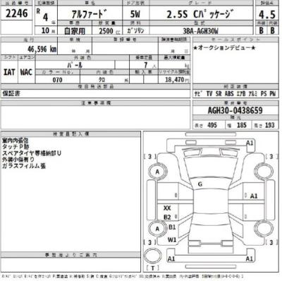

Plan to buy recon car, but dont know how to read the Auction Sheet. confused.gif
Alphard SC 2022
selling 202k now (price without insurance+ road tax- if included will be 209k)
Car Agent said is not R(accident) car, but ask ChatGPT by uploading Auction Sheet, ChatGPT said is R car with accident on back, but ald being repaired. "XX" saying some spare part is being replaced.
I not sure how accurate the ChatGPT on analyzing the Auction Sheet.
PLEASE PLEASE PLEASE, Anyone can help on this?
Question:
1. To confirm is R type car? How serious is this car in accident?
2. Should i proceed with the car agent if is R type car? feel they are not honest
3. if R type car, this price still worth? or what price is suit?

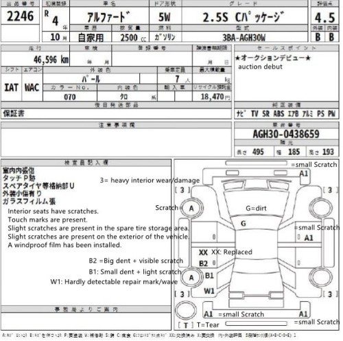

there are guides online. this one i found quite useful.
the top part except for the 4.5 are just car specs.
XX means replaced panels. and some b grade (dents) there, so maybe that area kena langgar before.
i dont think it's a R car, if it's an R, should be noted in place of the 4.5 grade there. likely just minor accident.
a1 means scratches all around. w means the panel got wavy, likely due to not perfect dent repair. g is windscreen chip. need to top up windscreen insu to replace.
overall i'd say it's not a perfect grade car, with some history la.
the middle left column is the one to take note, it's the auction note for the car. if you have higher quality pic, ask gemini or chatgpt to translate.

Top right box with the number 4.5 is the grade of the car. If the car had serious accident before it would be rated "R" at that box. 4.5 rating is the average rating.
That said do take precaution to get the auction sheet/report from other providers as well as sometimes the car could have gone through different auction at different places while in Japan and the assessment rating could be different. Also auction sheet provided by local dealer could be tampered.
