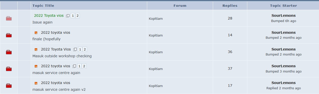

17/9 - Pusing steering got sound - https://forum.lowyat.net/index.php?showtopic=5539696&hl=
22/9 - masuk sc round 1 - https://forum.lowyat.net/index.php?showtopic=5540290&hl=
25/9 - masuk sc round 2 - https://forum.lowyat.net/index.php?showtopic=5540762&hl=
27/9
- masuk outside workshop to troubleshoot + drop off SC (3rd round SC) - https://forum.lowyat.net/index.php?showtopic=5540904&hl=
2/10 - masuk sc round 4th time - https://forum.lowyat.net/index.php?showtopic=5541546&hl=

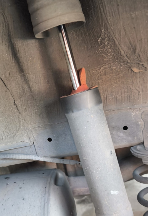

So halfway through after pass a hump today, I open bonnet. Lo and behold
Passenger side
Driver side
Since suspension warranty ended after 3 years, settle outside. change both side absorber mounting and bearing

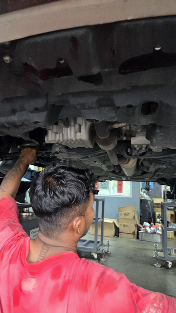

24/11/2025 5PM
Sound still same
Go another shop check is absorber
Replaced absorber
Still same issue

At workshop now

Checking

update: do shaking machine - retorqued the lower arm
still same sound

Tried this shop before... Total hopeless..
My suspension is multilink and this bugger only shake the front. My rear noise undiagnosed.
Front suspension simply diagnose. No problem say got problem. Got problem cannot find.

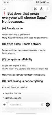

Chatgpt give me this answer
