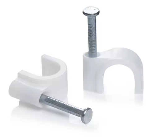

Use lan cable, pay wiring guy to do proper wiring to your room, that's will solve the problem
i just DIY and wire it in. of course neither this nor wiring guy will solve "ugly" or "dust" issue

QUOTE(Medufsaid @ Oct 24 2025, 06:03 PM)
nail susah. got ppl introduce me wire clip that uses double side tape. i found in daiso.
easy. toolless
Medufsaid
post Oct 24 2025, 08:02 PM
3,483 posts
ktek good tip... no holes to putty fill if no longer using
