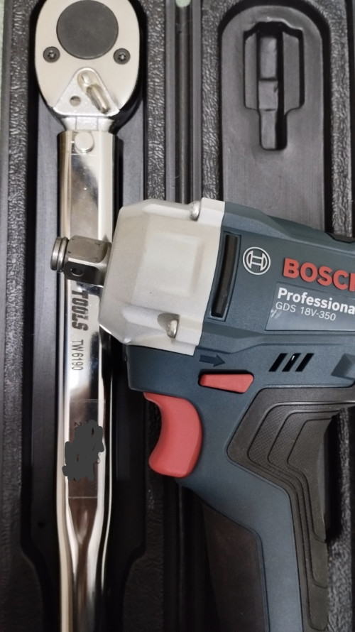

Like how do you even want to change it yourself unless you have all the tools required? You need a heavy duty air wrench, mallets and sockets of different sizes. Normal people don't even have a safety jack stand. After changing the lower arm you will need to do an alignment also.

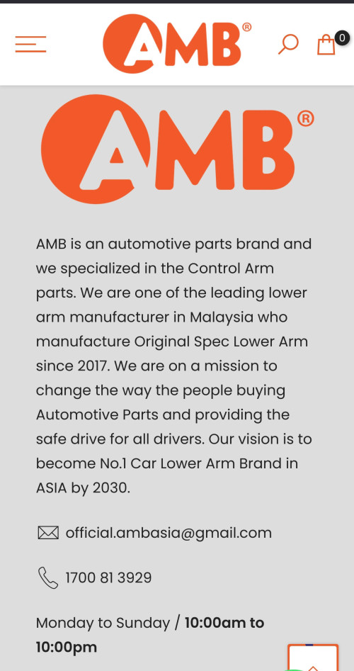

Thanks you for replying and the giving your opinions of lower arm brands and the quality.
Do you have any recommended link to buy genuine lokco denco lower arm and engine mounting?
Ayam are new to this.
AMB i have come across claimed they are the manufacter local mly brand with muteki brand.
