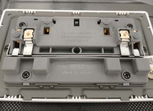

I want to change my wall socket from 1 hole > 2 hole.
So when I open up the wall socket. There is 3 colours wire.
The usual black/green/yellow.
But the 2 hole gang socket I bought got 4 holes.
So I confius which cable go which hole.
Is there a cable I need to separate the current? Or there is hole that I could ignore?

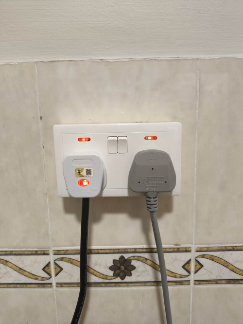

Update - mission successful

Got L and N
Then 2 ground

L for live cable (red, blue, yellow) neutral N is always black, and that terbaik tree symbol is for earth green color

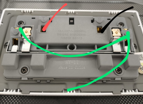

That means the ground cable, I install on which hole also will do? Just leave 1 empty?

QUOTE(KitZhai @ May 29 2025, 04:56 PM)
U connect the main ones to one hole then loop it to the second hole.

QUOTE(KitZhai @ May 29 2025, 03:56 PM)
Any one with do since it's linked with that rod in the middle
Yes leave the other empty
yes, there is steel plate loop there.
