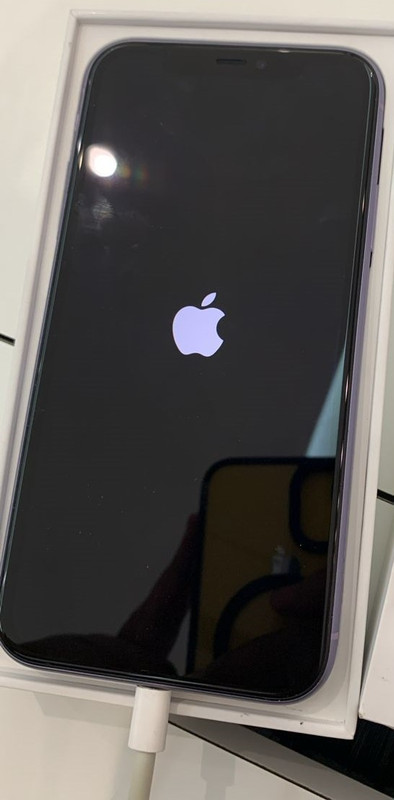

Hi, i have an iphone11 and when turn on the phone, it is stuck at apple logo. normally what's the problem with that? anyone facing this issue before and what is diagnosis and repair fee? thanks!

new phone, i bought a scrapped item actually hahaha... brand new ip11 from phone shop, the customer bought it, turn it on but stuck at apple logo. then the shop decided to sell the phone as scrapped item.

QUOTE(noobmaster_69 @ Mar 26 2025, 03:29 PM)
Can you attach a photo of that iphone of yours?
To be honest, there are videos of fake iphone which only boot up in apple logo - Basically a LED light up just to show a Apple logo cutout.

QUOTE(nebula87 @ Mar 26 2025, 03:40 PM)
the shop is switch, so i think wont be fake iphone.

QUOTE(noobmaster_69 @ Mar 26 2025, 03:56 PM)
i bought it for rm100, trying my luck see if repair cost will be reasonable.
Yeah, by the look of your photo. Yes it is a real iPhone.
Maybe you also can try connect it to your pc and install iTunes.
