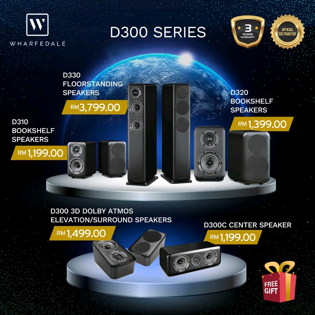

Example Wharfedale D300 more expensive than D320. RM1499 vs 1399.
This is true for every brands.
Why?

If the drivers are the same on both, it's just the added "angle" of the height speakers. It meant you can just mount it flat on your walls without buying a mount, that could also involve drilling into the standard bookshelf speakers. It's cosmetic "tax" more than functional.
It's like how razors for women are more expensive than men, even though it works the same.

Because the design for elevation speakers are more complex than 2 way bookshelf speakers. The crossover network may also be different (so no shared crossover network between the entire series) as these speakers may be used for upfiring duties.
The biggest reason though is that they sell on a much lower volume than the bookshelves, therefore a higher margin is needed.

You only pay Dolby tax for "Atmos" when your speakers are upfiring modules designed within Dolby's specifications.
These are just pre-angled mini bookshelves.

for upward firing mode, a different crossover is involved. different from normal on-wall speaker crossover. some speaker spec/description/manual talk about this change of crossover. a lot of them don't.
here's an example from Klipsch RP-500SA II that shows the switch:
https://www.klipsch.com/intl/products/rp-50...-sound-speakers
for the Wharfedale D300 on wall speaker, no info in the manual about the switch:
https://www.wharfedale.co.uk/wp-content/upl...anual-90722.pdf
https://www.wharfedale.co.uk/d300-3d/
does that mean there is no switch?
the manual doesn't have the word Atmos though. where is dolby tax? tongue.gif

Dolby Atmos "modules" are simply bookshelf/satellite speakers that are designed with an angled baffle and a crossover (that must be within Dolby's specs) to match. These are designated as "up-firing speakers" where you place them on-top of your bed channels (front L/R and surround L/R). They were all the hype and fud back in 2017-2019, before soundbars adopted it too. Up-firing speakers only work when you have a single seating position, have a low ceiling (optimally no more than 8ft) and must have a flat and completely reflective ceiling surface, so no ceiling fans or any fancy "cloud diffusers". The idea was that people don't want to drill holes in their ceiling or high up on their wall, so this was the best solution Dolby came up with.
Actual height channels that Dolby uses in commercial cinemas are mounted on the ceiling. Any half decent home theater will either use in-ceiling speakers or on wall height speakers. These speakers can be anything, ranging from bookshelves to individual drivers without cabinets (in-ceiling) or if you're crazy enough, go hang towers on the ceiling.

Yes well aware of the Klipsch.
I was trying to find info on the D300 spec sheet and no where does it say it has a crossover designed for Dolby's "up-firing" mode like you pointed out. So yeah I think it's simply down to volume of production on these height speakers for its higher price vs its other brothers.

what I'm worried is that if I buy the D300 (or anything similar to it without a switch), and assuming it has the electronics for ceiling reflection mode, it is going to sound wrong if wall mounted.

If a bookshelf designed for height duties isn't wearing the Atmos badge, it simply performs like a normal speaker as it lacks the crossover network for Dolby's up-firing specs. Dolby specifies that the crossover be cutoff at 150hz for DAES modules.
So no, it wouldn't sound wrong if you mount the D300 high up on the wall. What would make it sound wrong though is the position of it on the wall as the angle is preset and you can't adjust them without using an arm style bracket.

that is if you assume it has the normal crossover mode (like any other bookshelf speaker).
can we assume that if it doesn't have the Dolby branding, it doesn't have the upfiring/reflection crossover? since it doesn't have, why manufacturers still claim it can be placed on top of another speaker and use in upfiring/reflection mode?

Does ATMOS require a special ATMOS ready speaker to work?
Speaker designed for Atmos application are just normal speakers that have angled cabinets.
There is nothing special about the Atmos speaker drivers, any loudspeaker can be used for Atmos channel application provided it can be mounted in the appropriate location.
What does the Atmos switch do?
Some Atmos speakers will have an "Atmos" switch (like the one on the RP-500SA II). This switch just cuts the low frequencies to be outputted from this speaker - this is advised to be switched on when the speaker is used in the 2nd position - up-firing. Lower frequencies are not as directional as the higher and will not bounce well from the ceiling therefore it isn't necessary to send them to the speaker.
That's from Klipsch support page.
So if the upfiring speakers don't have the switch, they just output the full range that they can handle.
For any surround setup, you need good front speakers and a powered subwoofer. You can live without the powered subwoofer but you will feel the sound is lacking with certain content. Not just movies but music as well. If you analyze the surround content (you can open it using Audacity or any DAW), you can see that sometimes the LFE channel is being used to provide that bass kick; that sound effect exist only there.
Front speakers, even floorstanding ones with tweeters, mids and woofer, don't get below the 20-30 Hz level. The receiver will take those frequencies and gives it to the subwoofer. Adding the height speakers (DTS-X also uses these speakers) doesn't change this. Any low frequencies are still being handled by the subwoofer, as set on the receiver. So coming back to that Klipsch speaker, even if you forgot to switch to the Atmos position, you'd still be fine as long as you have a sub.
Any sound output that comes out of the receiver is "dumb". All 7.2.2/4/6 channels are analog signals. The processing is done by the receiver. When you use that calibration mic that comes with your receiver, the receiver uses that data to understand what condition the room it is in - the speaker placements, the room size and where you sit, for example. Using that data, it applies signal processing to hopefully give you a better sound, like you're in a concert venue or whatnot.
The newer receivers can know how loud your speakers can get and if they are lacking certain frequencies, and correct those anomalies. All of this while making the system user friendly.
So coming back to your original question, yes Wharfedale is forcing you the Dolby tax without the Klipsch low-freq switch.

Yes you can just use them as upfiring speakers without the Dolby spec'd crossover.
All you need to do is digitally bass manage by manually setting the crossover for the upfiring channels instead in the receiver. When I set it up for people, I use 120hz for the upfiring speakers.

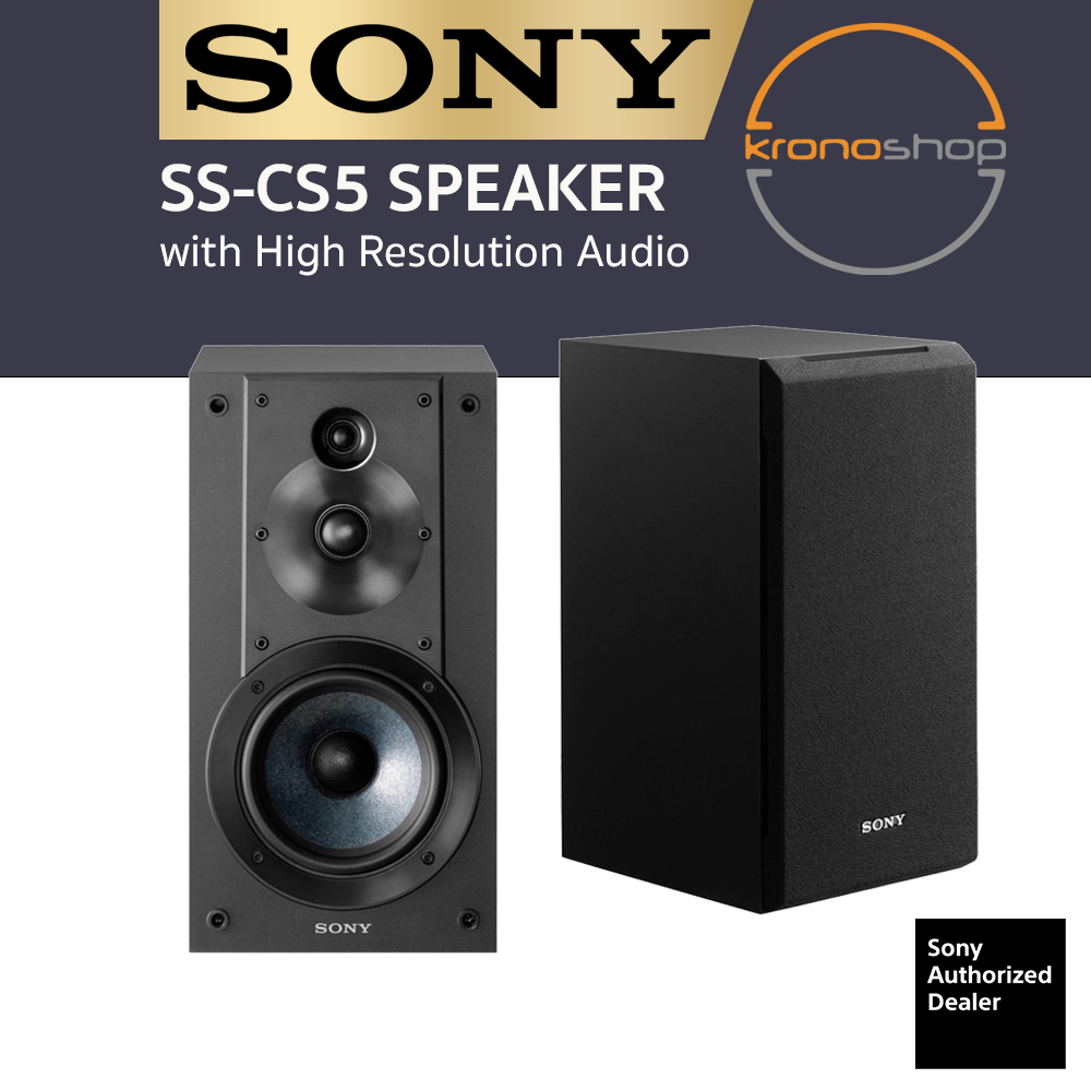

Here's the Sony CS5 bookshelf speakers.
RM700 a pair. 5 pairs is RM3,500 which gives you 10 speakers. Get a 10" powered subwoofer for around RM2,000, you have 5.1.4 setup.
For the Onkyo receiver (or any other 5.2.4 receiver) from the UK/US, you can try freight forwarding companies.
