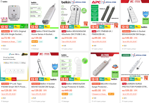

Does this kind of power surge protector work to prevent short circuit next time???

QUOTE(kimpetras2 @ Dec 7 2024, 09:39 PM)
Why would it short? Basically power adapter is converting ac to dc to charge the laptop. A short usually is just failing component or some water damage. The stock power adapter has a fuse just in case of power surge. Even if it fry, also fry power adapter first. If power adapter is okay, then I see no reason to buy a surge protector. Basically just failing components.
