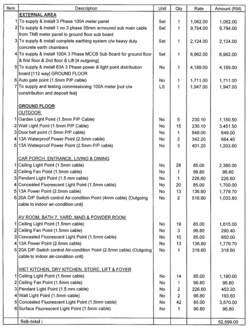

Hi all, I’ve received a quotation for electrical works from my contractor and would like to get your honest opinion on it. I’ve attached the quotation for your review.

Yea wor, he bought a land and built his dream house. But he not familiar with the electrical stuff so he ask me, and i got no experiences as well. I wonder how come one ceiling mount lighting point cost him RM 96.70, just wiring wor

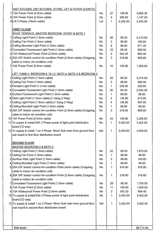

35mm Armoured Cable
from TNB Meter to your DB
RM9000+++++ ???????????????????
your house 5 kilometer long? ????
RM88 per meter from Shopee, Electrical store

3-Phase Incoming and the distance is around 30feets only shocking.gif shocking.gif

I just wonder what is the average price for a ceiling mount lighting points. Impossible RM 96 just for few thin wire ma right rclxub.gif

At first glance
1) Please look into the lighting point .. Only crazy people will direct lighting every point to DB.. looking at the BQ .. thats a lot of ceiling light point.
Contractor need to split the quantity
a) direct light point to DB - how many point direct to DB
b) How many point will be looping from the direct point (price should be lesser than the direct to DB price )
from that BQ- the contractor simply put everything as direct... not split looping and direct pricing..
this will save a lot of RM
2) Same goes to the 13amp power point.. not every point goes direct to DB... some point just need to loop side by side...... (depends on the electrical usage or appliances used)
3) Does this price inclusive concealed plastering works back after the installation of conduit?
hope this help
cheers mate
Izwan
www.archidstudio.com

What brand they quote for cable, socket etc?
Hopefully its a high quality product
