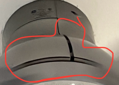

Hi guys, my KDK sensa 4 is almost a year old and recently have some clicking noise.
So I called up the service centre to check.
The technician can't identify the problem and even worse is he can't even install back the fan properly after dismantle.
Currently there is big gap between in the canopy and technician blame it's due to my hook is too high up in the ceiling(hiding inside the plaster ceiling).
The fan has been working well for a year without any gap in the canopy.
Now there is a big gap and he said nothing that he can do except I hire someone to redo the fan.
Anybody has any idea how to deal with the problem?

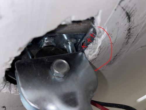

I tried to unscrew and see what’s going inside. This is the part where the service personnel complain. Any idea is it bad or wrongly installed into the plaster ceiling?
As for the canopy. I tried to fix it back and screw it properly, the canopy managed to close just fine right now. Technician said it’s impossible to close the other day.
This post has been edited by PowerGadget: May 5 2024, 08:43 PM
That's what I was trying to tell you. Just open it and reseat the thing. Nothing technical. Sometimes these plastic part doesn't clip in correctly and all you have to do is take them off and adjust the clipping nicely. No need vomit blood argue with technician.

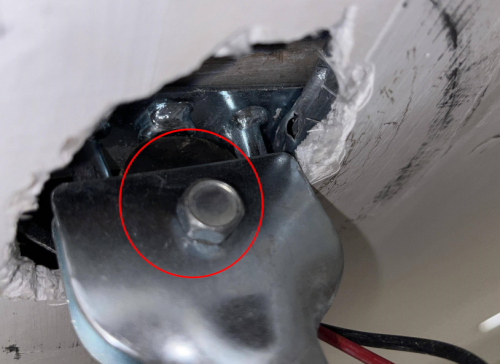

Thanks for the reminder. I do aware of this as well but without canopy, the sound is there also.
The fan run without any sound until the first inspection was done by the technician. Not sure what’s the main causes.
Is the fan hook attachment the culprit?
Currently it’s a wood that placed on top of my plaster ceiling. Not sure it’s correct way of installing.

Ok, this maybe a bit tricky to fix. It sound to me either, the motor is not smooth running, or the hook is vibrating or the structure that the hook is attached to is vibrating. Seems to me is something to do with resonance. A particular frequency cause large vibration.
What I can think of is that try realign the black rubber between the hook, you try to hold the fan and then slightly turn the black rubber so that hopefully it sits better between the hook. Or you can also change the rubber if you notice crack or something, or you can place some rubberize tape on the hook to see if it help.
As for the motor, hmm I have no idea to verify (probably test with another set of fan?), ...same goes for the house structure, tough to check.

Hello all Sifus, is the hook should be acting this way?
https://youtu.be/pd0e902u_Uk?si=O_B-NmuYPJ0E-LWc
