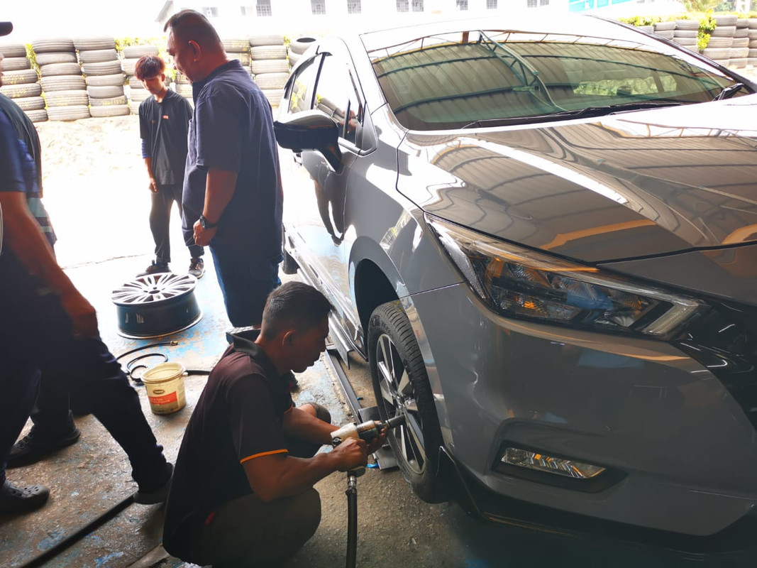

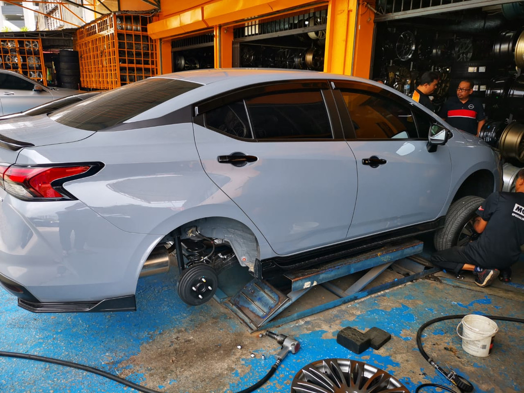

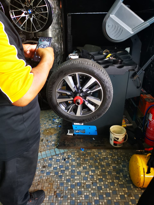

Update. Brought the vehicle to the service centre again this morning for 2nd checkup and test-drove another same Almera vehicle. Confirmed that the wheel bearing is not the issue, so the possibility of the noise is now entirely focused on the Continental UC6 tyres. The weird thing is the other Almera vehicle on UC6 tyres also showed the same humming noise, so I'm not sure if the humming noise is inherent with the UC6, or it's just the design of the rims or something else that contributes to the humming noise since other vehicles(Honda, Toyota etc.) on UC6 may not show this noise issue.
The current arrangement is the tyre manufacturer will inspect my vehicle to determine if the UC6 tyres are causing the humming noise.
