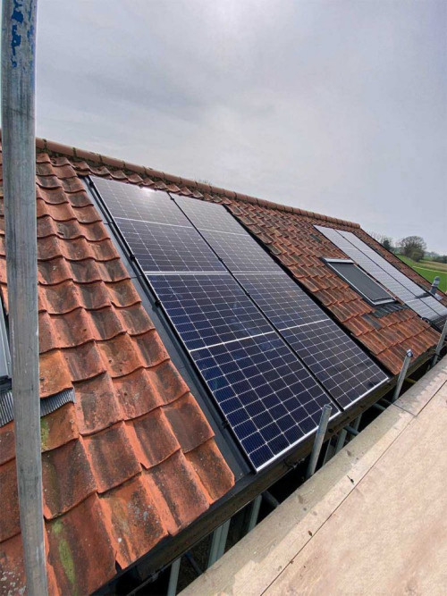

So meaning the tebuk lubang on your tiles? I need to visualize how solar panels are installed on roof
It will install bracket

Wait apparently you can do the integrated one

QUOTE(Avangelice @ Feb 6 2024, 03:40 PM)
They installed short standoffs and build frame to hold panels few inches from roof tiles. I think the house should be much cooler since the sun no more shine directly on the roof tiles. It is now like your roof is under an umbrella.

QUOTE(Avangelice @ Feb 6 2024, 03:43 PM)
I think I would not recommend this approach. More possibility of leak I guess.

QUOTE(Avangelice @ Feb 6 2024, 03:36 PM)
Question to all engineers, if I replace a certain Sq footage of my terracotta tilled roof with solar panels, wouldn't my house heat up since it's not a good heat conductor?
the solar panul is a 2nd layer over the roof. there should be less sunheat entering the house from the roof.
Yes , this also will made your roof leaking, normal practice is the solar panel installation on top of the roof panel not replace
No they use bracket to hook the rail then solar panel install and fastern on the rail
This one later if leaking happen , solar installer say not their problem BLA BLA BLA......
