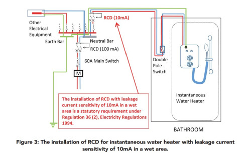

The 25mA and 10mA is the trigger point when the MCB tripped to protect people from electrocution. So, the 10mA is recommended to be installed at water heater by TNB.
The water heater circuit breaker is additional to the house MCB.

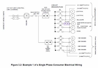

Here is the guideline from TNB
You can see where the 10mA breaker is.

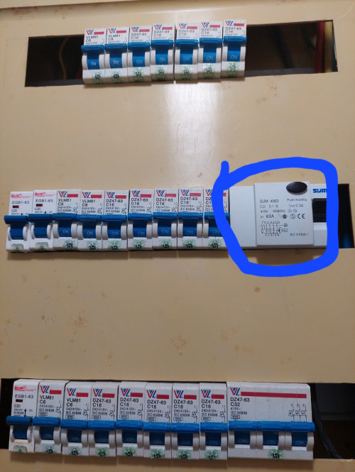

Sorry I'm lost, I'm using C16 as photo, does it too high or low for the 42 kwh water heater? C16 mean for 16A right? ChatGPT ask me to get C25, salesman said C16 ok for it, so confusing. Appreciate for your reply.

QUOTE(FyChai @ Dec 28 2023, 09:04 PM)

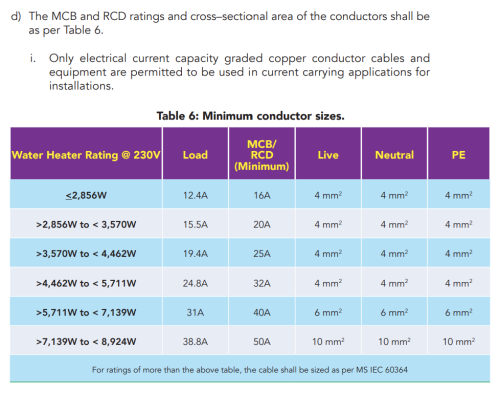

C16 OK for 3300W WH.
4200W WH pls run a new line (electrician required) with 6mmsq cable else you gonna burn down ur hse. Of coz salesman everything can, burn also not his place

Table above and below is taken from Suruhanjaya Tenaga's guideline. So basically for instant water heaters (common ones are from 3.6kW to 4.5kW), they will require the MCBs / RCDs to be 25A rated with 10mA sensitivity (for appliances installed in wet areas). 25A is the current rating (In), 10mA is the trip sensitivity.
In conclusion, I think u will need a 25A rated current, 10mA sensitivity, double pole (cut live and neutral) RCD. Experts, please correct me if I am wrong.

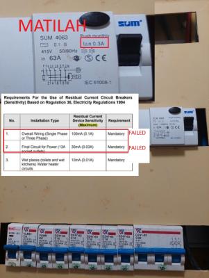

QUOTE(FyChai @ Dec 28 2023, 11:17 PM)
I had read that post, inside said 25A MCB RCB, but other post said 10mA, so which one should I use? C10 or C25?
Please do not confuse between RCD and MCB.
MCB you have now is a C16 to safely allow up to 16A LOAD.
RCD which you don't have now, and you will need, is a 10mA RCD rated to sense up to 25A, this is the bestest protection -
https://shopee.com.my/ABB-F202-25-0.01-ELCB...1856.9133931062
or this also can, if budget is an issue
https://shopee.com.my/Schneider-Easy9-25A-2...4033.3943044744
Failure to install a proper 10mA RCD will lead to unwanted outcome, usually death.

Since we're here,
your existing installation is totally illegal, and is useless for human life protection.
4.2kW instant water heater should only require 4mmsq cable, not 6mmsq cable, according to Suruhanjaya Tenaga's table above. If I am reading the table correctly.
With the advent of fake cable and substandard cables nowadays, plus not being the installer meaning can't control the quality of cables being used, overspec is better. It doesn't cost much more.

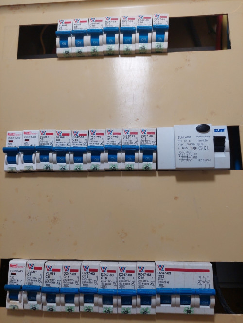

The DB is ori set from developer, I just add on 3 MCB on left hand side for dry and wet kitchen. May I know is that call MCCB for my current 63A breaker? If I change to 100mA, do I need to upgrade or remain 63A?
As per pic above, do I need to place 1 RCB for every floor? Or just for the cable which use for water heater?
Sorry lots of questions, i need more knowledge before asking a electrician to visit again. Previous electrician came to check and never mention about the 300mA of breaker and RCB until I find it myself.

You have been running your current water heater which is rated 3.5kW – 5.5kW for so many years already and your wire probably a 4mm² wire. I think it should be just fine to just use the same wire.
The wire can carry 32A roughly if it is inside tubing or directly nailed on or inside the wall cement wall. Your 4.2kW water heater will max at 18.3A @230V. I would consider it as continuous load current. So, I would derate wire requirement. 1.25 x 18.3 = 22.875A which i still within the wire load capability.
You need to install a 100mA RCD (not MCB as mentioned by ceo684. This is for safety against electrocution. You do not want any current more than 10mA run through your body if accidentally touch wire or if the water heater got leak current. You can put it on wall just before the 2 pole switch inside single breaker casing if you do not have space in main DB box.

QUOTE(FyChai @ Dec 29 2023, 08:52 AM)
Just for the water heater for safety. If use 10mA for whole house then you probably will experience unnecessary tripping smile.gif
30mA not 100mA. Otherwise still fail on the Final Circuit for 13A SSO 30mA regulation.
