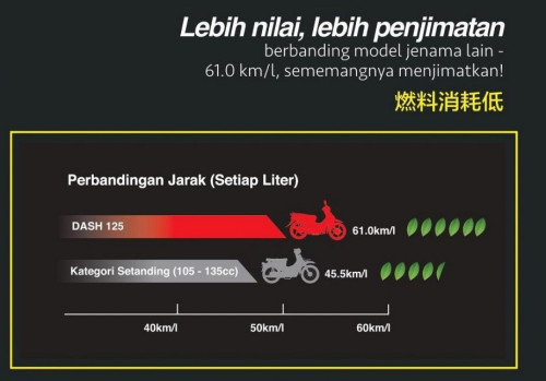

Dash 125 fuel consumption as claimed by honda : 61 km/l
Vario 125 fuel consumption as claimed by honda: 51.7 km/l
I dunno how that translates into real world fuel consumption rate but my dash125 consistently got around 49 - 53 km/l of fuel consumption with my riding average speed of 70 - 95 kmh. Just want to share my input la.. smile.gif

Yeah. Advertisement always exaggerate. Like huawei watch claim 14 days but need to turn off all features.
53km/l isnt that bad. Thanks for sharing.
