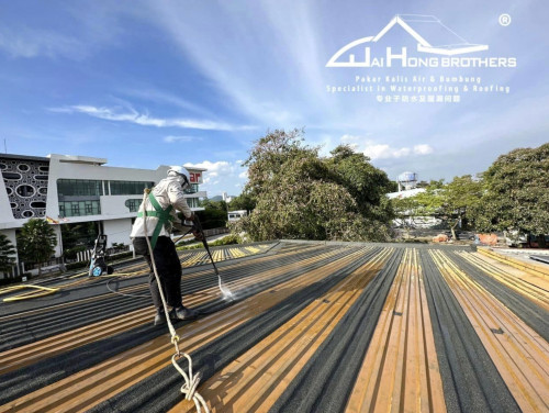

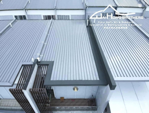

From what I gather, they extensively use torch on membrane to fix all issues (whether it is cement, steel roof, roof tiles, etc). I've heard of torch on membrane and its application on cement slabs only usually.
I've actually contacted them for a quotation, which came to over RM20k. Basically almost "wrapping" all four corners of my roof + rolling down over required spots. The logic makes sense, i.e. they don't just patch the problematic area, but always start from the top of where the water would flow.

Example of the concept (mine is a metal deck roof as well):

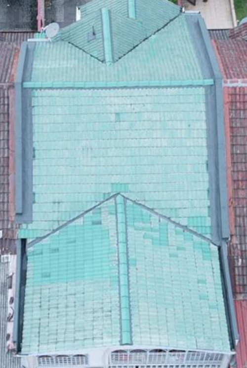

The picture you shown is similar to what they will be doing.
Just a bit hesitant on the huge price gap. Mine is also a link house, not a bungalow or anything.
I wonder if I am being overcharged or if there is some mistake in the calculations (it's purely done using a drone and the measurements are drawn based on pictures taken by the drone).
