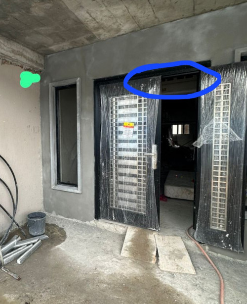

My house under renovation and extend hall 4ft front so the meter has to be moved.
Blue circle in the picture is the old "front" wall now extend 4ft out.
The green dot is the place where TNB contractor will drill to pull wiring from neighbour side to join to mine.
Please take not on the other neighbour side no drilling required because that part of wall no extension (only extend half of the wall)
TNB contractor estimated RM1800 cost to move the meter.
Anyone done before is this price justified?
Also if i want to move the meter to the outside at the porce gate pillar, is the price gonna be higher?

QUOTE(WaCKy-Angel @ Aug 23 2023, 07:23 PM)
Please do not use other contractor aside from appointed TNB contractor otherwise they can charge you tempered with the meter , because the meter got seal with it. You can always nego the fees good luck

Your case is relocate from wall to gate pillar?
Btw 1 phase or 3 phase?
Do u have photos of the meter before and after moved? So i can gauge RM1800 quoted for me justified or not.
That RM1800 to relocate to pillar is not my case...i havent ask the contractor about other ppl quoted that price.
