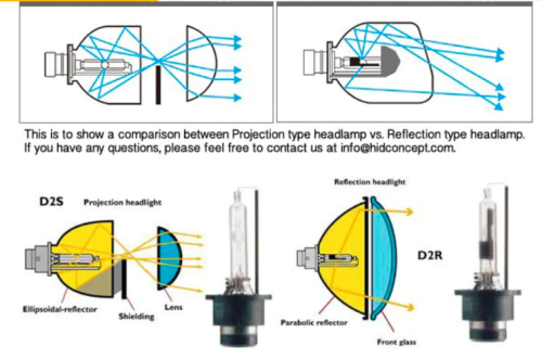

reflector headlight or projector headlight with auto leveling?

in simple terms
can you see the bulb or just seeing a opaque half circle while looking from the front

do not install if your headlights is halogen type,will blind people

if projecter ok, if reflector dont

Proceed if it projector type.
if ur car using reflector type, dont as it will proceed to glare other road users. Doesnt't matter if you do levelling after that, the reflection of the LED (if previous model is halogen bulb) is bad, there will be light leak that glare others.(except for Honda City, the reflector used in that model (current gen/previous gen) seems to work ok with LED).
Dont buy china one, lifetime is not good. If you see other that uses LED but only 1 side is working, mostly using china one. It just did not last long. buy a branded one like OSRAM or Philips

same, i tried before, will blind opposite people also

you can get H4 led projector if you have reflector type housing, but you still need to adjust the beam afterward.
and also the high beam is shit on those led projector..

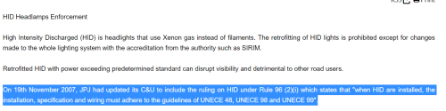

Kytz
post Jul 18 2023, 01:59 PM
572 posts
Joined: Jun 2005
Don't do it unless you're prepared to pay to change it back when JPJ catches you.

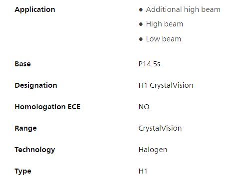

post Jul 18 2023, 02:05 PM
518 posts
Joined: May 2006
QUOTE(Virlution @ Jul 18 2023, 12:53 PM)
What is the E ratings? what are the ratings? need to look in to this.
good tip on dimensions...
I also worry that the bulb with the heat sink and all cannot fit in or cannot close the dust cap afterwards
Its actually E mark. Has not seen any on sale anywhere that got this mark yet. Even Philips MY website says their LED offerings does not conform to ECE. Halogen models all have their "Product Description --> Homologation ECE" status as YES, while LED models all marked as NO.
Philips Automotive Lights MY
JPJ stated in their public website that car lights must conform with ECE ruling listed, as below
JPJ Technical

TSVirlution
post Jul 18 2023, 02:51 PM
483 posts
Joined: Jan 2010
QUOTE(speedy3210 @ Jul 18 2023, 02:05 PM)
JPJ Technical

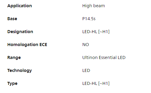

Looking at Philips WhiteVision Ultra 4200k specs, it's Homologation ECE but the Philips Crystal Vision 4300k does not have Homologation ECE
Also very strange that the specs only states its for High Beam, meaning if use for low beam, will the life span be effected or will melt the housing due to heat?

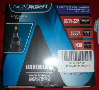

This doesn't look like a Narva packaging
Better you just get the real Narva in Narva packaging. Not that pricy also.

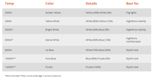

Philips Ultinon range looks ok as well....
I'm using Philips X-treme Ultinon LED on my 208gti.
Not cheap, at about rm7xx after discount but it's good.
The light has a bit of yellowish tint which is good for rainy days. It's not 6000k or 6500k pure white. I'll say it's slightly below 6000k.

Never use led in reflector type housing. Bulb and led simply spread the light differently when used in reflector housing.

QUOTE(sanosizo @ Jul 19 2023, 07:39 AM)
Watch more led bulb reviews on YouTube.
You'll change your opinion on this

QUOTE(Virlution @ Jul 18 2023, 02:32 PM)
4300k is halogen bulb.
even no hujan also cannot see road but off the lights then will notice the darkness around
halogen is no good.... compared to my other car with HID, so nice.
but pasang high beam I can see very thing, keep high beam stock colour temp
LED bulb is 5800-6500k
I think 6000 above is too blue already, keep to lower range better.

Factory fitted HID have a glare shield as the output is a lot higher, while halogen bulbs dont have.
So when people modify the headlights to HID, but did not include the glare shield, it ends up blinding on coming car or so....
Some people tune the headlights lower to compensate but most dont or dont know about this.

Looking at phillips ... I prefer lower temp, 6000k probably too blue for my liking and invite police kacau during block.
SUSskyblu3
post Jul 19 2023, 09:58 AM
157 posts
Joined: Jan 2013
QUOTE(Virlution @ Jul 19 2023, 09:56 AM)
Then you should get Phillips.
Phillips are usually slightly below 6000k
TSVirlution
post Jul 19 2023, 10:01 AM
483 posts
Joined: Jan 2010
QUOTE(skyblu3 @ Jul 19 2023, 09:58 AM)
Ultinon Essential is 6500k
Ultinon Pro is 5800K
have to find cheap source with good reputations
Factory fitted hid depends on the headlamp type.
Projector type doesn't need the glare shield/sheet.
Hid have two types. For projectors and reflector headlamp. Reflector type has an "R" in the bulb type name. D2R, D4R, etc.

QUOTE(Virlution @ Jul 19 2023, 10:01 AM)
Stay away from 6500k
a million thanks. so it's not about the bulb. it's the whole light assy/installation.

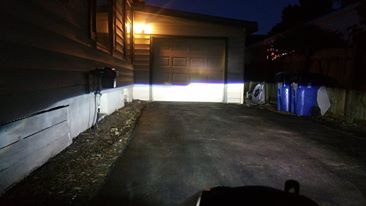

QUOTE(Virlution @ Jul 19 2023, 09:53 AM)
H4 don't have glare shield?

ANY conversion of lights that is different and NOT same as stock is illegal. It doesn't matter if it is HID or LED.
Meaning, if change to HID/LED that follows stock specifications then it is NOT illegal.
so since when HID is ILLEGAL? It is only illegal if you dont follow stock specifications of your car.
enough of acting like a know it all la, you are a serial bullshitter
https://www.jpj.gov.my/en/web/main-site/tek...mps-enforcement
News below on JPJ tangkap illegal headlights.
https://www.thestar.com.my/news/nation/2023...s-silau-in-sibu
Maybe he'll say it's only illegal in Sibu. MR_alien, your comment please, since you asked for proof?
This post has been edited by mushigen: Jul 19 2023, 03:14 PM

QUOTE
Faizal said, retrofitting LED and HID lights is an offence under Rule 94 of the Motor Vehicle (Construction and Use) Rules 1959 and can be fined up to RM2,000 or imprisonment not exceeding six months under Section 119(1) of the Road Transport Act (APJ) 1987.
TSVirlution

colour temp is is measure in temp (Kelvin)
I prefer to stick to below 5000K
QUOTE
Many car buyers believe that yellow lights penetrate fog better. But, the reason is something else. You now know that blue light falls right in front of our eyes. When we see any object in blue light, it appears fuzzy or unclear with a blue-tone around it. It is a phenomenon called “glare”. According to a study, blue light is often the reason behind driver complaints of discomfort glare. Blue or white light against the snow or fog can be glaring for the eyes and it can make you tired soon. When you are driving through snowy roads, the white lights can tire you as well
BenYeeHua

Yes, color temperature is the wavelength side, specially doing coloring on fog and raining etc.

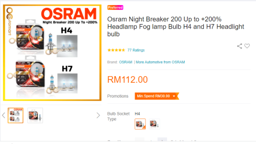

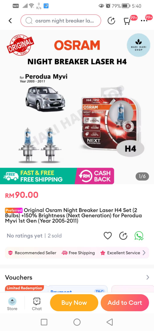

I used this
Osram Night Breaker Laser NB200
RM113 only
https://shope.ee/1VVW1f1WZW
and this
Philips Ultinon Essential LED
RM175.00
https://shope.ee/8A2Py3CVjL
way better than stock bulbs

I pakai Philips Ultinon Essential LED saja already gooding
RM175.00

Change to LED bulb ONLY if ur lampu besar is lense type.
If projector or reflector, the light hitting the road in front is actually lesser than halogen.
Bcos halogen bulb emit light 360deg. While LED bulb's design structure only emit 120deg + 120deg.

if you are not into the looks just want normal light, go use those like Philips extreme vision plus or Orasm NightBreaker 200, like 30~50% brighter then normal cheap halogen bulb the mechanic or SC will install for you.
talking about looks and functionality, once you dabble into higher colour temp, the same bulb will look not as bright as these normal bulbs due to how our eyes see the wavelenght and need higher lumens

QUOTE(LA773 @ Jul 19 2023, 05:43 PM)
if your car is using H4 bulb, just change back existing H4.... dont bother going LED unless you hand itchy, there are cooling fans in the bulb might cause interference, too white, police kacau, etc..
this is good, Night Breaker 200, standard 12v, 55W bulb

yeah cause simply the design of the reflector with halogen is a thin wired in the middle
where as, as thin and small the LED module be, it can never be the same location as the Halogen light wire

TSVirlution
post Sep 12 2023, 10:20 AM
483 posts
Joined: Jan 2010
I have been using the novsight LED bulbs for months already....
Feedback,
seems to be better than my halogen bulb, however it is not as good as my other car with stock HID.
I had look around trying to see if its blinding other cars or not, including putting my other car in front of it and driving around the car or towards it. Its not blinding as my car got projector style lights.
Light dispersion, the light seem to disperse to the left, like the nike swoosh being flip 180. Good for looking at house number at night.
I tried to adjust the headlights angling (there are some screws on the headlight casing) had angle it as low as possible or as high as possible, play with the bulb Left/right but cant do much due to the angle/direction the bulb need to go into the housing.
I can't see rain puddles on the road until splash on them when it is raining. I can see the water on the road, but not sure if its puddle or just wet road, so have to drive slower.
If there are no cars around and it is totally dark, it perform pretty good. If it is not too dark and many cars with HID about, I cant see much due to the light temp/colour.
Can hear the fan whining sound. Cant lock the bulbs in the housing properly, but the plastic dust cap keeps the bulbs in place. the heat sink becomes hot, but no problem so far.
Cheaper and better then using those 4000~4300K halogen bulbs.
If you use those standard yellow halogen (this is probably the best) and value for money, just not to nice to look at.

fuyoh banyak kaya pakai ultinon pro ! that is > rm400 already
RM175.00

New ultinon access is very straight forward plug n play design. Maybe can make a compilation/sharing thread for led light bulb which is good and which suck. Nowadays road too many sohai car with reflector then put led chapalang one macibai.
https://shp.ee/poscch1

my previous Novsight LED with fan become not bright after a while... I think once it become hot as it will be bright again if it switch it off and back on again.
Auxito arrived, just pasang in the car, I find it much better so far, see how it goes tonight I take it out for 1 hour drive....

TS, Auxito or Novsight better? Im looking in to H7, but with one Auxito brand, they got like several models and i dont know where to begin with
M5S, Q16, Q10, GFM etc......

now on Auxito....
my Novsight after almost 1 year, it become dimm when it hot and the fan is noisy, harder to install also. so Auxito better as newer tech
