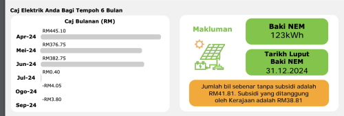

Installation already completed on september 7th . Now is already 1 month after the solar installation .
30 days solar generated = 1440kwh .
My electric bill from RM650 drop to RM25 only .
During this 30 days of testing , i actually increase my electricity usage . I start to turn on my living room aircon 3-5 hours daily .
Pros of installing solar panel :
1) TNB electricity bill is subsidized and have tiers , it is cheaper for the first 300 kwh , and after 300kwh is about RM0.5 per kwh .
With solar , total kwh of the month will minus total solar generated , then only they will calculate according to the tier and bill you . In other words , the solar generated electricity will cover the most expensive tier for you .
2) With the new ICPT implementation, if your electricity monthly usage is above 1500kwh , you will be charged about rm150 extra monthly .
But with solar system , it is almost impossible to reach 1500kwh . As during day time when the solar is generating electricity, it will actually supply to your home electricity before sending the surplus back to the grid .
Example :
Monthly usage 1600kwh , solar generated 1500kwh .
But the meter will show 900kwh , solar generated 800kwh .
Coz the 700kwh is tallies during the day use .
3) You can have the freeeom to utilize air conditioner during hot days . Cause you will know that if it is a hot day , your solar will generate alot of electricity that day . This is a very good balance of temperature in your house , though not very environmentally friendly 😀

hi, just share my information after 2 month solar panel installation
-signed up NEM in May
-installed in july
-received rm 4k rebate after 2 week of installation
-solar panel: 12 x 605w
-total generated 815kw in August
-total generated 763kw in Sep
-my last 6 months tnb bill:
