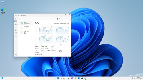

MS also try to expand territory on different CPU.
WOA (Windows on Arm)
Hardware low spec, very slow.
Suggest use a more powerful machine.
This post has been edited by flashang: Jun 9 2023, 09:06 AM

QUOTE(flashang @ Jun 9 2023, 09:04 AM)
Might wanna upgrade your storage speed before looking into CPUs.
TSflashang
post Jun 9 2023, 12:21 PM
355 posts
Joined: Aug 2021
QUOTE(angch @ Jun 9 2023, 11:55 AM)
Have to upgrade all...
More RAM, faster and bigger storage, probably faster CPU (Depends on board)
