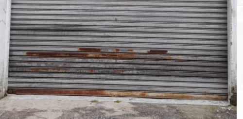

my fren roller shutter rusting [pic below]. he asked me what paint good to fix the rust?
looked at oxide primer (csm 1 liter RM15) and PYE Rust Converter (0.1 liter RM15) i ask sifu here for advice which one can handle this rust or maybe got others ......

since u gg to hw shop
buy some rough-medium grit sandpaper ~80grit forget the super fine
metal brush as well
u need to sand down the rusty patches that is a given
for the other good paint that one just give it good wash with dishwash or soap powder, surface need to be clean
primer whatever red oxide primer or silver also ok one
but note that primer isn't a finish paint
rust converter not much use
finish with gloss paint of your choice. multiple thin coats work better.

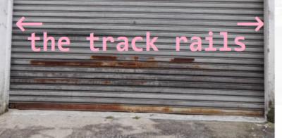

if you wanna ensure a smooth roll for the roller shutter can consider lubing the insides of the track rail with toyo grease
