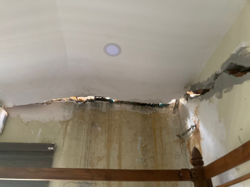

Hai there, Izwan here, want to share with future house owner who is doing house extension-e.g Kitchen, porch etc...
So 2 years back got this owner who basically got a house at nilai...after giving all the proper quotations ... owner keep quiet and decided to get a cheaper Indonesian contractor. instead...so just wish him all the best on the renovations lor....
Got a call last week, ,and he ask to come over and asking for an advice regarding this situation his having....im assuming those typical roof leaking, water seepage since malaysia is currently having its monsoon season....
To my surprise, the renovation extension went horribly wrong.

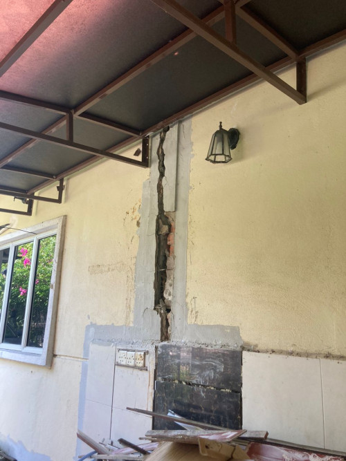

On my findings , this is the issues that the house is having:-

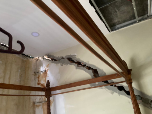

1) The new ground and first floor back extension is not properly structurally design. The first floor floor beam and the roof beam is tie to the original existing beam.
and same goes to the first floor R.C slab.....
A new extension should have created another new column after the existing building so that this old and new building have different structure loading purpose.

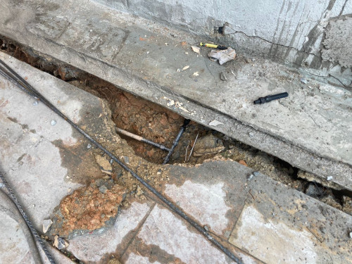

2) The ground beam missing... hahahaha..... crazy.....
3) Column design / R.C footing under design... so the double storey extension load cannot catered by the Footing and column thus settlement occurred .
The new beam and slab connecting to the existing building is producing "shear stress" that causes the building to have a major crack....
So... my question is to you all.... what do you think you all should do if this situation suddenly occurred to your house...?????

wow, there is a huge crack line

Yeap… I have to decline to do the job due to the hazardous condition…this demolition need to use manual labour due to no machinery access …it’s like you are playing a game of “jenga blocks”…. One wrong move can easily make the building collapse…. Dangerous for workers …..if front extension still ok , just use machinery …..

how did they make the crack? dig the soil below the house? usually the land movement only cause that, or the pilling is not done properly, else is the remove the soil, then the soil move and cracked the wall, this has become structural damage, may need engineer to verify if the house is still safe to stay, and if it is link house, those house besides also need to do thorough check

Already mention to owner get structure engineer to verify ….got settlement occurred due to the double storey extension loading …. So basically the footing , stump , column under design ….
Best option extension for a double storey or 3 storey back extension is raft foundation design …the whole load seating on top of one giant plate or RC slab…

6) since settlement already occurred.. need to backfill , compact again soil.... and if necessary have to do soil test....
