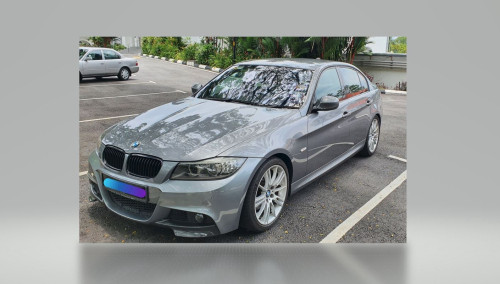

I used to own an E90 325i LCI and I can attest that the engine is quite reliable. The only issue I faced was random oil leaks from worn gaskets i.e. oil cooler, oil pan, valvetronic and etc. Power is decent but the high revving sound is the best part of engine. The engine does consume some engine oil depending on your driving style and quality of oil used where interval top ups (maximum 1 litre) may be required.
Do also take note the petrol consumption is quite high where I used to average around 12.6L / 100KM for urban driving.
Picture of my car before i sold it. Gosh i miss this car.

Its normal for bmw consume engine oil if less than 1 liter per interval 10k km. The engine design. With leaking seals it will be an extra. If the leaking always happen then check the catalytic. Clogged catalytic will result more pressure in engine thus easily leak. My catalytic clog and the fc become 8-9km/liter now. Later need to decat.
You had a beauty man. No wonder you miss her. !!
Thanks for tip on the engine oil consumption, will take note of it. Also its nice to personally hear the experience of an ex-owner who still misses the car.
