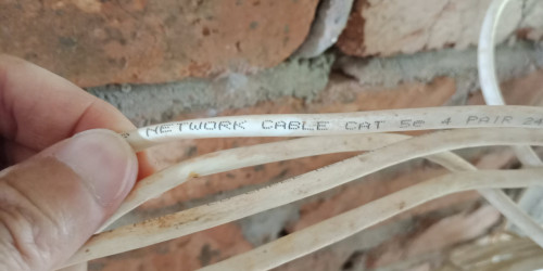

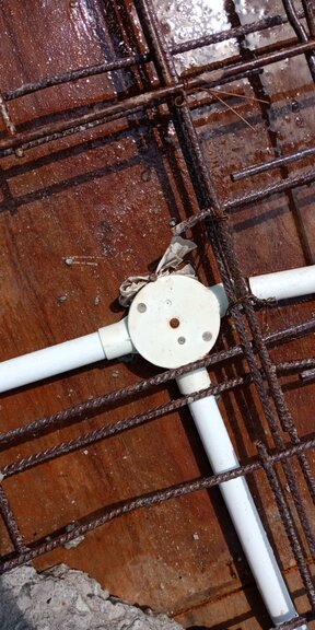

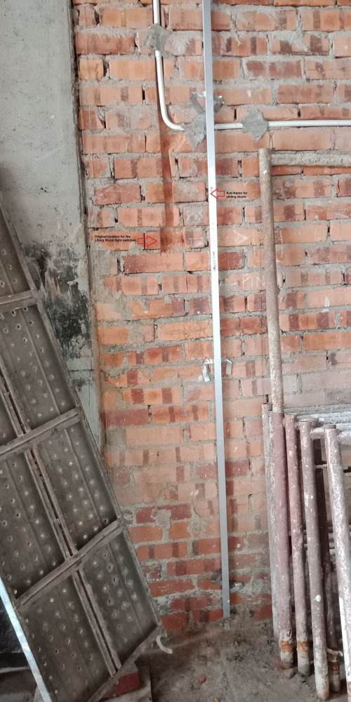

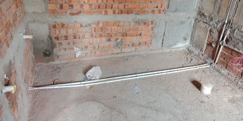

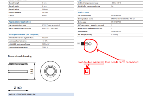

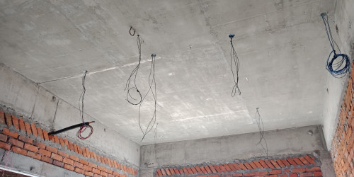

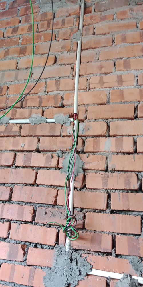

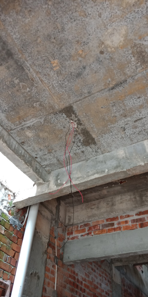

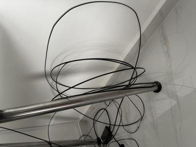

I am going to share the quality of the "Data Centre" electrician. He claimed that he has done several data centres. Contract signed is Cat6 wire. Get the foreign labour to lay Cat5e unbranded wire.
These are the quality of the "Data Centre" electrician, not mentioned the light, aircond and fan switches of my living room are put at car porch:
Pendant light point is placed next to the fan.
Cat5e was used despite the contract and pricing is Cat6. Argument is I don't need Cat6 for CCTV. But, price is the same.
Because I said I will use LED light, no Earth line for the points.
My requirement is concealed and this picture shows my bathroom. The network and 13A cables were put like this. Below the sinks. If he forgot to place the PVC conduit during casting of slab, he can hack. But, the electrician refused unless I paid VO price. Like this, can I do water proofing?
For a 60 sen joint that was broken - would you replace a new one or tore a piece of paper and cover the hole?
wait.. what..

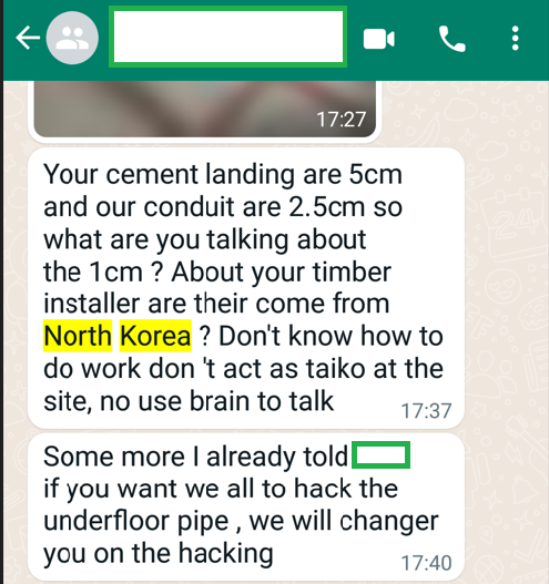

QUOTE(zak3 @ Aug 1 2022, 10:40 AM)
wait.. what..
Never see before, right? I have more than 5 parties (timber installers, plaster ceiling, electricians, and etc) came to my site and comment it was not safe. Anyone said it is not safe, to this data centre electrician, you are from North Korea.
RM90 per point for concealed. But, he wanted to charge me VO if I need to the PVC pipe to be inside the RC floor. All these contractors think that I am a water fish for their to slaughter. laugh.gif
Frankly speaking, where is the conduit on your ceiling, all hidden inside the ceiling?
Than on the conduit in your toilet floor, so when completed and you discover that the water proofing not working and may have to redo it, how that guy gonna hack your tiles, accidentally hack, conduit pecah or maybe kena short circuit...
For those light points, the conduits are in the RC slab. The conduits were installed when the construction workers build the mould for the RC slab. The electricians missed out the conduits for the power and network. The conduits on the floors were done by his subcontractors (mainly foreign labour that can speak Bahasa or English).

QUOTE(ongss @ Jul 29 2022, 11:59 AM)
Actually, my price was back in May 2021. The problem I face is the location. The moment they know the address, they have many reasons to raise the price.
Recently, I joined a facebook group (mainly for Mandarin users) and got a few electricians to quote me. The price per light point is only RM 65 - 75 per point and the 13A is only RM 100 per point for the current market price.
I can feel the pain when I saw this. My condo was done by a group of foreigner as well while the so called AIO designer gave me a name list of Chinese name.
And I only found out lately after the full payment that all my ceiling fans' safety wire were not installed. They just slot the safety wire back into the plaster ceiling. I sent the photo to the ID lady and she blamed me that I didn't check it when handover and I was the only customer that complained their poor workmanship. So again it became my fault.
I really hate ppl that with no work ethic and integrity even she was graduated oversea from Australia and holding master degree. So there was nothing to do with high or low education. Just that you can hardly find one good ppl in KL.

QUOTE(kimteck @ Aug 4 2022, 10:54 AM)
I have invited several electricians came to inspect and re-quote. Most of them were terrified by the quality and even suggested me to bring in Suruhanjaya Tenaga or CIDB as the foreigners that did the wiring obviously did not have the P4 wireman qualification.
I have given my main con a dateline to settle this. Otherwise, I will upload the photo the FB groups to share the pains. https://www.facebook.com/groups/155815638381028/about has 121K members and another group https://www.facebook.com/groups/1465699686984899/about has 76K members.
The photo I showed were minimum, I have captured a lot others, e.g. wiring can be done the following:
No T-joint box was fitted
Bedrooms have the following PVC conduit on the floors, to be covered by the 50mm cement rendering. But, my timber installer needed to have 40mm gap between the PVC conduit and the nails. VO price will be applied if I request to hack and embed the conduit into the slab. Prices quoted were supposed to be concealed last year.
This post has been edited by ongss: Aug 4 2022, 11:53 AM
im not a 'fan' of conduit running on 'floor'.. doesn't it suppoed to run on ceiling/under roof/anything above.. unsure.gif

QUOTE(zak3 @ Aug 5 2022, 04:57 PM)
Amazed by the Data Centre electrician, right? His Myanmar subcontractor even placed the switches (light and fan) of the living room at the car porch.
Floor easy to grind the trench ma.
QUOTE(ongss @ Aug 5 2022, 05:50 PM)
I am amazed by his antics considering that yours is mainly brickwall and not RC walls. RC walls are a mess (hard work and the likes) to hack

QUOTE(ceo684 @ Aug 5 2022, 05:58 PM)
I am fine with China method as long as my timber installer does not hit the conduit.
But, I guess the electrician thought I am a waterfish and his VO price can slaughter me.
Now that I have a little time to look thru.. the lack of T-joint means the cables are not mechanically protected. rclxub.gif
ongss
post Aug 6 2022, 10:31 AM
426 posts
Joined: Jun 2008
QUOTE(ceo684 @ Aug 5 2022, 11:04 PM)

Anyone have ideas on how to tidy up this unifi fibre cable? See image
The cable is quite tough itself.

QUOTE(Chiggah @ Oct 7 2022, 09:10 AM)
Just curl it slowly. Don't bend it. After that, use a cable strap to secure it. U can buy those from Mr DIY or Daiso.
careful with this optic cable.
dont sharp bend.. u'll end up with broken optic cable later.
just slowly curl to big round bundle.
cable tie or velcro tape it nicely and hang somewhere.
this seems like outdoor fibre cable sweat.gif and yes is quite tough, it may has a kind of steel string attach together
usually reach our house FWS only, and then white indoor fibre which is easier to tidy up
but recent years, seems no longer provide FWS

QUOTE(vez @ Oct 9 2022, 10:56 AM)
How to get this done properly ? Call Unifi or electrician from our own pocket ?
If you have ceiling in that room, then you can still do jointing on the pendant light point and use flexible to shift its location. else. then surface conduit, which will be ugly.
You have to ask him to give you CAT6, cos you paid for it. Doesnt matter if you dont need cat6 for cctv. You paid for it. Unless he gives you negative VO for the difference of cost.
Lighting normally has no earthing, so it’s ok.
Best not to run conduits in the screed or under tiles. Best to have top down approach. But since your slab already cast, why not run the points in the ceiling and hack the wall? unless no ceiling. Yes you can still do waterproofing. but it has to be below the conduits. meaning you still hav to lift the conduits to apply waterproofing, and once dry, then reinstall the conduits. so might as well run high level in the ceiling, and do new routes in the wall.
If it was a 4 way junction box that was cut to become a T, then he should just replace. If its a T junction box, and nothing was damaged, maybe he just put the paper there to provide friction against the nail. During casting there could be alot of vibration and that box could move. But who knows, need to be there to inspect the slab prior to casting.
ongss
post Oct 18 2022, 07:05 PM
426 posts
Joined: Jun 2008
QUOTE(epicure @ Oct 18 2022, 11:22 AM)
I terminated the electrician and now new electrician is re-wiring everything. Everything seems to be good and the pricing is more reasonable.
All points are required to have an Earth. Whether it is used, or not, for the light fitting is not for the electrician to decide.

QUOTE(stormer.lyn @ Oct 18 2022, 07:51 PM)
That's why I said normally. For lighting there are typically no terminals to connect earth to. So it's unused at the fitting end.

QUOTE(epicure @ Oct 18 2022, 10:30 PM)
Again, you know if the fitting has an Earth terminal or not that you can say no need to run the Earth wire? ongss doesn't want a plaster ceiling, so it has to be a surface mounted LED fitting. From the images of the site, ongss has every right to be pissed off at the "electrician" for the shoddy, below par work.
You should be ashamed of yourself if you are anywhere close to the industry, and you should be demanding better service if you are the end user. Why are you trying to defend the sh!t work?
What else? You don't normally get into an accident, so no need to wear a seat belt?

QUOTE(stormer.lyn @ Oct 19 2022, 08:02 AM)
You are right that LED also required earth line. Before selecting the current electrician, there were around 7 electricians came to view. All of them refused to continue from what left behind and wanted to start all over again. As I awarded this piece of work to the main contractor, he was struggling not to find someone that will minimise his losses. All (including the current new one) concluded that the work is below par.
