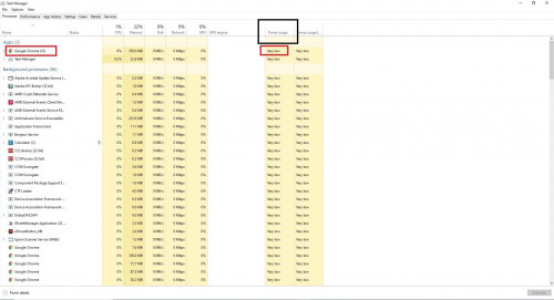

QUOTE(mstmohdkut @ Nov 23 2021, 10:30 PM)
most likely psu as sudden surge of power from chrome makes the psu unable to take the load
see in task manager under power consumption see if the power surge uncontrollably
try with different psu if have any spare see if that solve the prob
can you show me task manager under power consumption
where to seee can you show me then i will show you
sorry don't have spare PSU
mstmohdkut
post Nov 24 2021, 01:55 PM
68 posts
Joined: Mar 2005
QUOTE(tng55 @ Nov 23 2021, 11:07 PM)
i have highlighted
one other thing you can try also is system restore to a date when u didnt face this problem
see if that solve it
This post has been edited by mstmohdkut: Nov 24 2021, 01:56 PM

i have highlighted
if very low mean handle PSU right
my PSU is Corsair VS550 for 550Watts its not enough ????

QUOTE(tng55 @ Nov 24 2021, 01:58 PM)
PC Spec
asus prime h510m-d
i7 11700K
RAM 16GB X2 32GB G.skill tridentz neo
no GPU no Gaming
Corsair VS550
we use onboard GPU intel connected VGA
yes
but check all chrome app in the task manager
if there is one consuming alot of power then try disable all extension and add on
yes more than enough

Cpu usage very low but power usage very high
Here task manager
