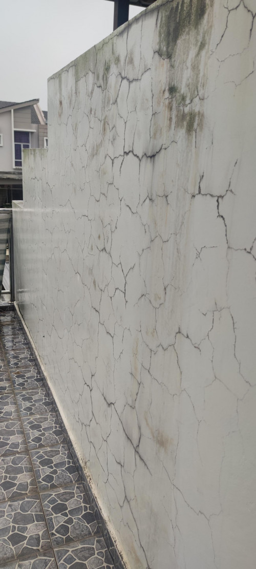

My car porch walls have a lot of crack lines. I am looking for contractor to repair. Not keen on tiling up the wall cause too expensive nor do i plan to paint it. I thought of just doing smooth cement finish
Any advise what i should tell the contractor to ensure that the wall will not have crack lines and can last? does it need waterproofing or sealant paint?

Hi! It is best to remove all paint then sealed up the crack line with cement (special for crack repair).
Then apply good sealant paint or waterproof paint which is having high elongation.
Personally, I recommend Dong Fang Yu Hong - Smar Coating.

QUOTE(mini orchard @ Nov 23 2021, 03:43 PM)
Any photos to share ?
This post has been edited by 7up: Nov 23 2021, 04:23 PM

Woah...
This look like serious...
Was thinking just small hairline crack... Here & there...
This one...
I think huh..
Needed to take out whole cement layer... Until can see bricks....
And replaster cement layer back...
Later after like 1 week...
Weatherproof paint....

Skim coat and paint it. Use a good brand exterior wall paint. Not those water base maxilite etc.
This post has been edited by mini orchard: Nov 23 2021, 05:41 PM

QUOTE(nexona88 @ Nov 23 2021, 05:10 PM)
Woah...
This one...
I think huh..
Why need to wait after 1 week?
nexona88
post Nov 23 2021, 11:15 PM
The Royal Club Member
48,568 posts
Joined: Sep 2014
From: REality
QUOTE(7up @ Nov 23 2021, 08:52 PM)
To make the cement set & dry properly...
If not, the one u face now would appear again (reason why your wall become like that)..... All rush job done previously....
Cement based things like mortar/concrete is not an instant superglue.
Its a whole chemical process that need to slowly cure to release water vapour and other gases, in order to achieve maximum strength.
This is why we can't build whole apartment in 2 months (more like it needs 3-4 years) if follow the standard 28 days concrete curing process. It need to harden before you build next floor up.
China did it in 2 months (59 storey) because they pre-cast the thing somewhere else and just assemble lego blocks like our LRT track sections.
If you suffocate it by painting it over too quickly, before it cures completely, the cement is still wet inside and prone to failure.
For me I am OCD on this - after redoing I will let it cure to maximum strength at 28 days if possible, before painting over.

What about if i want to add on tiles? Do we need to wait for the cement to dry up then do the tiling or its done together?
nexona88
post Nov 27 2021, 05:33 PM
48,568 posts
Joined: Sep 2014
From: REality
QUOTE(7up @ Nov 25 2021, 04:00 PM)
What I know...
Existing wall...
The contractor would drill small hole the whole wall...
If damage... Then cement plastering.... Normally few days keep dry...
Then tile up...
Since yours is outdoor...
Please pick heavy duty type... And not so big...
Later the tile might dropped off from the wall 😁 to be on safe side... 1x1 better... Some use 2x1 also....
Price piece around rm3 to 9....
