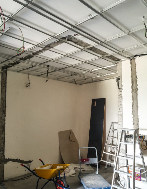

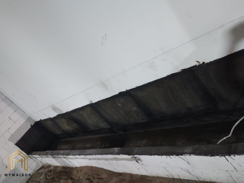

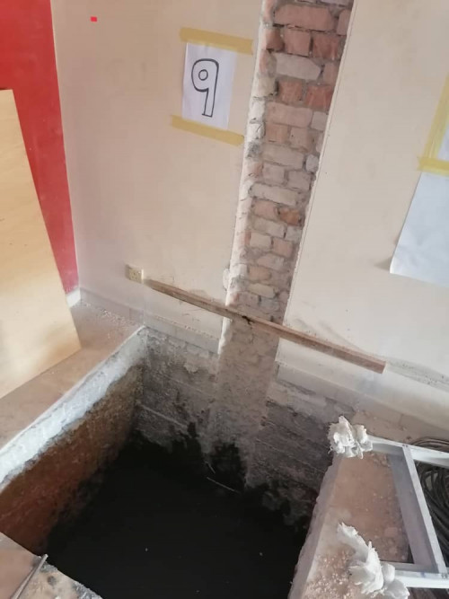

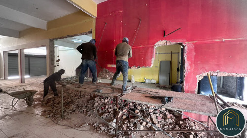

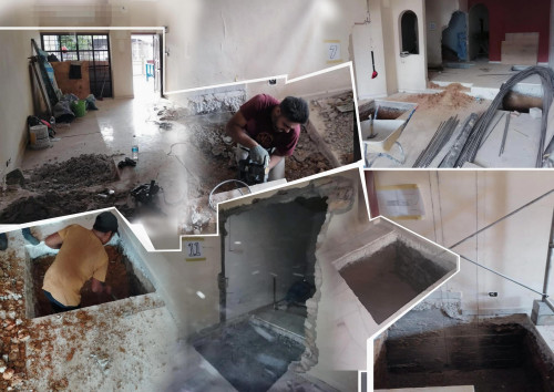

PROJECT A-
Topic: Hacking & Demolition Works rclxms.gif
We hack the unwanted brick walls and floors which are not going to be used in future design. At the same time, we indicate the new column locations with labels before starting to dig the hole for the foundation of your house.
We dig the hole right to the ground below. A square base is formed. You will definitely create a lot of mess as a lot of construction waste, ground mud etc are scattered around. However, all of these are normal! So, don't forget to clean up the working area and accumulate the waste in your construction bin outside. icon_idea.gif
Next, we also dismantle the plaster ceilings for the entire house. You could see clearly all of the supporting structures and piping concealed above your house now. Similarly, we dispose of all of the waste into the bin. Get rid of them by lorry once it is full.
Remember that the dismantling job can take up some cost on you as well when doing renovation. Thus, do remember to include this step while considering your budget.
This post has been edited by My Maison: Jul 14 2021, 04:42 PM

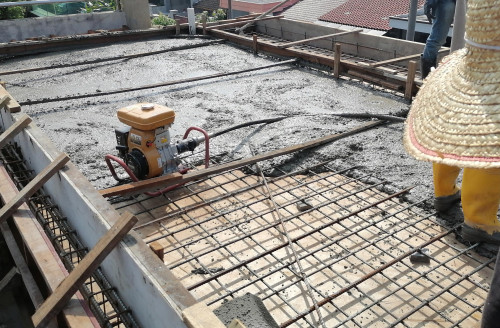

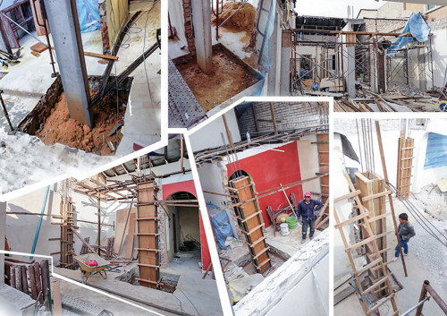

PROJECT A-
Topic: Constructing Column Footing
After cleaning up all of the unwanted wastes, we start to build footing for our columns.
Pour the concrete inside with steel rods added as reinforcement to form a strong rc footing.
This post has been edited by My Maison: Jul 16 2021, 03:27 PM

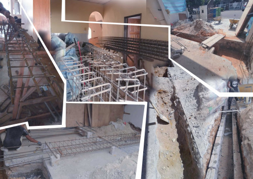

Project A -
Topic: Preparing Rebar and Constructing Ground Beam rclxm9.gif
Construction of RC ground beam is important in maintaining the structural stability of a building. We firstly prepare the reinforcement bar structure with desired length, as shown in the diagram above. icon_idea.gif
We excavate the ground for the allocation of the ground beam. Before casting concrete, we lay bricks along the perimeter, forming the shape. Next, we place the rebar inside, fitting nicely before pouring concrete inside.
Wait for the concrete mixture to dry and your RC ground beam is ready! icon_rolleyes.gif

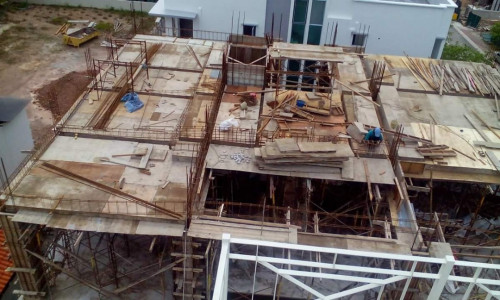

Project A -
Topic: Dismantling the roof, ceiling structure and walls
From the pictures shown above, we ensure that the construction bin is empty before demolition works continue. We then remove the roof tiles and the structure above.
Ceiling boards and roof structures are removed as well. To follow the new design configuration, we hack all the non-structural brick walls, tidy up the area and lastly to transport all of the construction wastes to the disposal area.

PROJECT A -
Topic: Preparation for Column Construction rclxm9.gif
A stable RC column is important in resisting the compressive and tensile forces. Without proper reinforcement, concrete columns can buckle or burst outward.
For the rebar, rectangular stirrups (ties) are firstly bent with the bending tool. The stirrups encircle the vertical pieces of main rebar with proper span among each other. Use a pair of pliers and tie wire to tie each end of overlap, as shown in the illustrations above.
After locating each rebar at its own place, you can start cutting the plywood to the required size, as the preparation for the construction of traditional timber formwork. icon_rolleyes.gif
