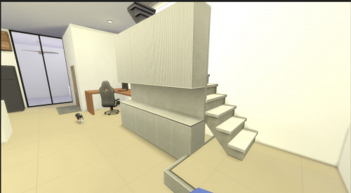

So far, we have yet to decide should we hire Interior Designer, but we have roughly designed our dream layout for our home via a game call Sims 4:
Sims 4 Design Draft

Design Draft made by myself:
https://forum.lowyat.net/index.php?showtopi...ost&p=101699783

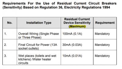

PSA on electrical safety since you haven't started anything.
For water heater safety
WH circuit if you are redoing the wiring for it, use 4.0mm² cables per ST spec.
Good cables from Mega Kabel/Caramay/Fajar Cable cost more. But they are "cheng liu" with all the SIRIM legit certification.
There are elcheapo/fake cables at half price I also don't dare to install in customer premises. Safety first.
More importantly each WH circuit (basically each unit) need its own 10mA RCD/RCBO 0.01A (NOT 0.1A).
Check DB box to see if such thing exist.
For further reading Attached File  Guideline_for_The_Design_Installation_Inspection_Testing_Operation_and_Maintenance_of_Water_Heater_Systems__1_.pdf ( 4.49mb ) Number of downloads: 25
Having a 10mA RCD fitted will prevent the likelihood of becoming news material.
https://www.straitstimes.com/asia/se-asia/m...e-having-shower
https://www.malaymail.com/news/malaysia/202...c-shock/1896447
For whole house electrical safety
Per ST (Suruhanjaya Tenaga) regulations - to be fully compliant - you should use a 30mA whole house high sensitivity RCD (0.03A NOT 0.3A) for human life safety.
100mA & 300mA RCDs should only be used in commercial/industrial as they are NOT very useful to protect human life
They are commonly fitted in residential as they are indeed cheap coz less sensitive and they are only good for preventing building from catching fire.

QUOTE(ceo684 @ May 8 2021, 09:29 PM)

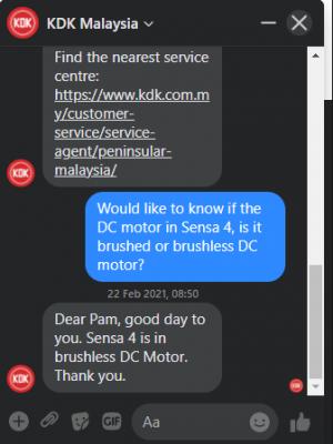

Thank you so much for the guidance! I'll keep this in mind, my brother is an electrician so I don't want to cheap out on electrical else my brother will nag me if I do!
Also, do you prefer AC or DC Water heat?
Based on my research it seems like DC pump is more long last and quieter, but not as powerful as AC?

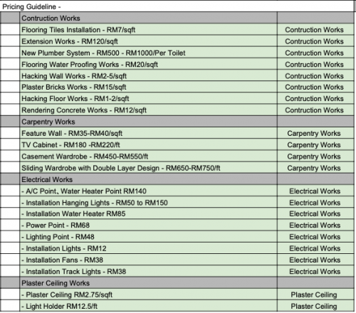

1. To be really honest, we have no idea what are the current market price, so we only estimate price by comparing IKEA, Shopee, Lazada.
3. We don’t intend to get luxurious branding but intend to get long lasting material. For e.g: Panasonic, LG are well branded for their Aircon and Washing Machine respectively.

1. Your kitchen is aluminum or wood? If IKEA I don't think they have aluminum. I think your kitchen budget is almost there, but your hood and hub I think on the lower side.
2. Your ceiling fan only RM180? How come so cheap? The one I am eyeing Panasonic DC with LED around RM700 to RM740. If you always on your fan, better get one with DC motor.
3. May I know who you engaging for your bathroom cabinet? It seems I need to check if my kitchen and wardrobe cabinet suppliers do bathroom one or not. I missed out on this.
4. You might want to consider costs of water filter, not cheap. POE and POU add up can be around 1 to 3k depending on what you choose.
5. Your costs for lightning includes ceiling plaster?
Seems to me some of your items are reasonably priced but some seems on the low side. Anyway good thread and good luck to you. I only ask questions in this forum on some of the thing, but lazy to do what you do! LOL.
Most welcome. Good to know you've got someone competent to handle the electrical works. thumbup.gif
DC pump WH is better than AC. AC pump always noisier than the DC pump.
However if water pressure is good enough (this one really need to bring a hose to test on site) i.e. using just your thumb [fingerprint, not stuffing the thumb inside the hose ] to cover the water flow, try to stop the water, then you may NOT need a pump model.
> If you can stop the water with your thumb = water pressure weak. Get WH pump model.
> If it is virtually impossible to stop the water with your thumb = water pressure good. WH pump optional.
https://shopee.com.my/KDK-K14ZW-56-Sensa-4-...5032.5642458864
All AC motor are brushless.
DC motor can be brushed or brushless type so need to make sure its brushless for long life.
