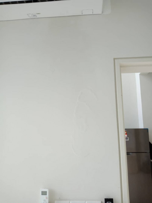

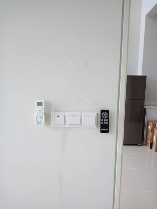

TSNewsray
post Dec 2 2020, 08:37 AM
1,022 posts
Joined: Dec 2011
QUOTE(mini orchard @ Dec 1 2020, 07:06 AM)
The ac technician confirmed the leak ?
Any photos to show the leak ?
The the contractor that installed mine confirmed nothing to do with him.
He was not the taichi type because he actually spent time working on another ac that has some gas leak.
below air cond has dry surface and no water anywhere.
slightly over half a meter down, can see water inside the painting and water leak out of the switches due to hole/gap.
This post has been edited by Newsray: Dec 2 2020, 08:39 AM
mini orchard
post Dec 2 2020, 09:13 AM
10k Club
14,511 posts
Joined: Sep 2017
QUOTE(Newsray @ Dec 2 2020, 08:37 AM)
I am not sure which contractor will install the drainage pipe above the lighting switch socket.
Drainage pipe is straight down and will not leak unless there is a connecting elbow. You can try opening the ac casing cover and pour water at the mouth of the drainage pipe to see there is any blockage ... use as much water possible.
BTW, can you take a complete photo of the ac and light switches in one.

TSNewsray
post Dec 2 2020, 09:17 AM
1,022 posts
Joined: Dec 2011
QUOTE(mini orchard @ Dec 2 2020, 09:13 AM)
i tried to take the photo in 1 but then it would be difficult to see the water mark. I cant get a full picture that still able to show the water mark clearly.
there is actually another ac behind the wall of this air cond (for the living room).
i guess both air cond drainage pipe joined somewhere below and it leak there.
This post has been edited by Newsray: Dec 2 2020, 09:26 AM

mini orchard
post Dec 2 2020, 09:31 AM
10k Club
14,511 posts
Joined: Sep 2017
QUOTE(Newsray @ Dec 2 2020, 09:17 AM)
I suspect is the wall copper piping touching the switch socket wires and water drip down when condensation happens during ac running time.
The ac water outlet mouth is located right or left ?
