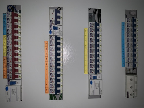

#4
852 posts Joined: Mar 2005 From: Penang |
Oct 4 2020, 10:56 PM
