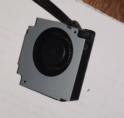

this blower fan is quite powerful, so i mod it to run at USB 5V instead of 12V.
use the air to directly cool the NVME without any heatsink
taped this side to cover the conductive metal side since sandwich it between heatsink and GC.
put there in between GC and CPU heatsink to blow directly onto NVME.
do note that whatever normal fan is super hard to fit and the pressure not strong enough, only blower type will do its job well

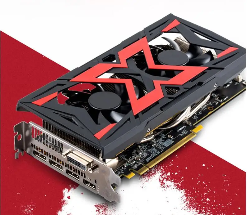

GC originally looks like this

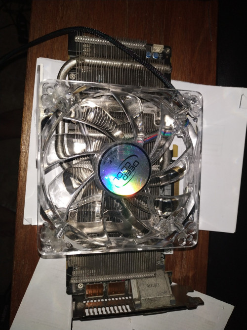

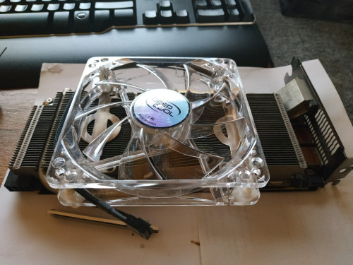

stripped down everything, then slap a 120mm fan on it. i used glue gun to stick the fan onto the fan shroud

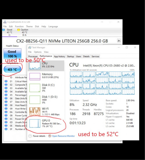

results are quite good, NVME now runs same temperature as traditional HDD.
i tried sticking tiny heatsinks on NVME but doesnt work great, only an active cooling can do its job
even GC dont make whiny noise when full load during gaming

I'm running 15browsers at once.
Temperature about 43 only, before that it's 50
If on AC about 39
