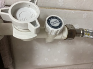

try this first. u know the small intake water filter below it. clean it.
tersumbat make water flow low pressure. if ur stopper edy used to high pressure, sudden low pressure will make the washer “loose”

Revamperz
post May 15 2020, 04:56 PM
im freaking IN! ™
5,164 posts
QUOTE(chanhin @ May 15 2020, 04:30 PM)
Not sure what can open for cleaning.. later I try to open here and there la.. everything seems very tight...
it look something like this. inside like plastic filter. u not knowing mean it not been clean since 10 years too sweat.gif
just make sure stop the water source first

I'm replying to 4 yo thread. Thank God I managed to rectify the problem of water can't stop flowing. I suspected something wrong with the inlet body. Maybe the rubber washer need to be replaced or something.
The culprit was few grain of sands that got stuck in the inlet body prevented the valve from fully close.
anakkk
post Aug 22 2024, 06:57 PM
2,119 posts
Joined: Apr 2013
QUOTE(emkay @ Jan 25 2024, 12:10 AM)
my unit just started to have the problem these few weeks, is it easy to replace?
