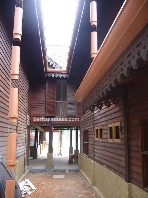

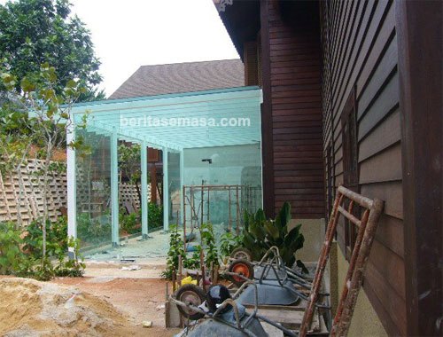

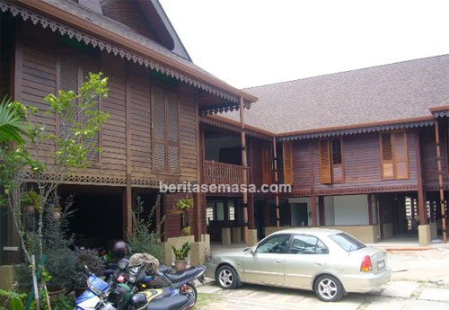

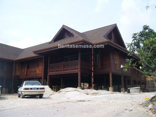

Found this while I am looking for Chenggal:
http://www.mtc.com.my/resources-Projects-C...useLangkawi.php
Looks very nice.
I believe it can be build cheaper if steel frame and structure is used and wood only for walls, flooring and cladding?

QUOTE(Angelic Layer @ Apr 4 2019, 07:12 AM)
Looks very nice.
Actually no need for chengal, balau and merbau timber... Now timber treatment is good enuff... Jus that the design have to be right... Glulam and CLT is the way forward to utilise smaller timber... Heck even pine can be use if the proper treatment and design is apply...

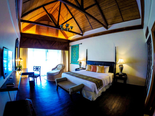

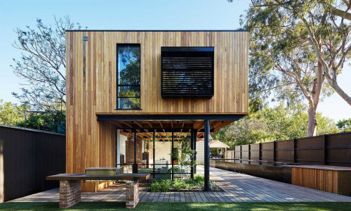

Some seaside/island resort home built using timber

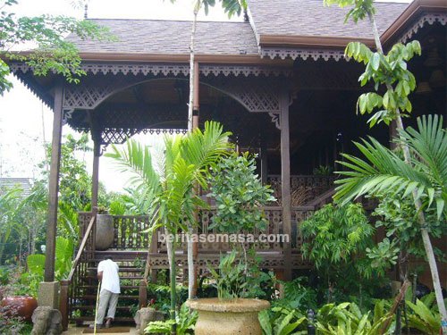

Cengal woods are gooding yo.My mother in law house nearly 80 years old now still standing strong as ever but offcourse nowadays not cost effective la...Too expensive.

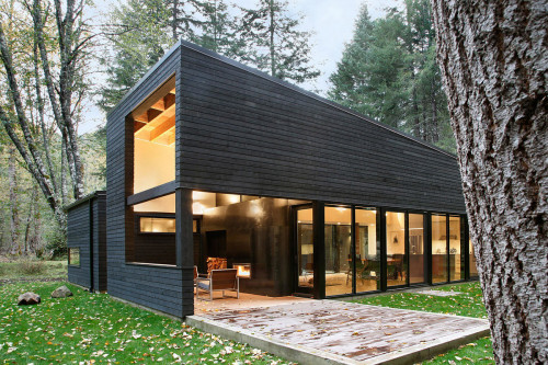

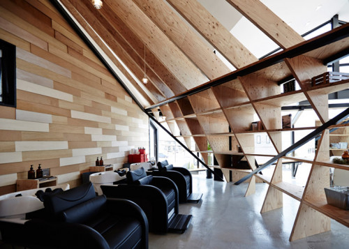

QUOTE(HangPC2 @ Apr 4 2019, 09:43 AM)
I really like traditional house in some way as well, but the handicraft is almost pupus and certainly more expensive to build.

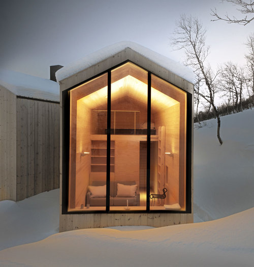

I haven't seen it done in modern style in Malaysia before:

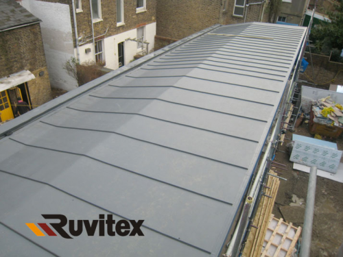

QUOTE(jerm57 @ Apr 4 2019, 10:11 AM)
Single layer design of course turn into a sauna box lah. Do double layer with insulation in between can mitigate the heat. Many house in USA/Canada also using this design. Outer layer can be any material including wood, zinc or those polymer plastics. Cottage country area hardly use brick/cement for houses.
Zincalume roof + rockwool layer + double sided alum layers
proven low heat system

QUOTE(lagista @ Apr 4 2019, 10:14 AM)
Altho zinc sheet is cheap, it is loud as fuck when it rains. Fibre cement is quieter but the cost. sweat.gif sweat.gif sweat.gif
ar188
post Apr 4 2019, 11:08 AM
9,206 posts
Joined: Jun 2006
QUOTE(jerm57 @ Apr 4 2019, 11:06 AM)
thats why he said put rockwool layer.. for heat, and also sound insulation.

QUOTE(ar188 @ Apr 4 2019, 11:08 AM)
nowadays metal roof with foam.. one piece.
That's true but insulated cement roof will still be quieter than insulated zinc.

QUOTE(jerm57 @ Apr 4 2019, 11:13 AM)
where u find cement roof? got pic?

QUOTE(ar188 @ Apr 4 2019, 11:15 AM)
Not actually pure cement. It's fibre cement roof. Can buy from most construction suppliers.
https://en.wikipedia.org/wiki/Fibre_cement

QUOTE(jerm57 @ Apr 4 2019, 11:18 AM)
Looks very nice.

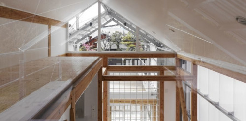

SUSAngelic Layer
post Apr 4 2019, 11:38 AM
91 posts
QUOTE(mousqy @ Apr 4 2019, 11:28 AM)
how about wooden house murica style
Those are good but the wood used for framing must be good quality and expensive, if it was me I would considered use steel for frame, and wood for the rest.
A lot of Japanese house like Sekisui house, Daiwa house company build their house this way.

QUOTE(ar188 @ Apr 4 2019, 11:39 AM)
tornado or hurricane come , all fly away.. they have improved their wooden house building technology with special brackets and fasterners. unless you use the lastest technology to build.. the old way is not so safe. thats why the old brick houses in europe after 300-400years old still around.  biggrin.gif
QUOTE(RicoT @ Apr 4 2019, 11:40 AM)
Japan lots of wooden house still okay what
Yes, the oldest wood structure in Japan, Horyuji Temple lasted for more than 1400 years, but the material and workmanship is unobtainable today.
That's why I ask about wooden house in modern style and design, then we can eat the cake while save the cost, material and time.

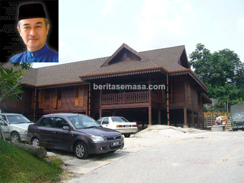

acbc
post Apr 4 2019, 11:56 AM
9,050 posts
Pak Lah. At Kampong Penchala. Malay house outside but traditional English design inside. I did the timber flooring inside. All using American Walnut. Other contractors did the plaster ceiling, wall paneling and kitchen.

QUOTE(acbc @ Apr 4 2019, 11:56 AM)
That one cost 12 million right?

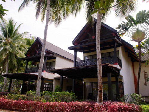

one of the more impressive timber structure in Malaysia is at karambunai nexus resot in sabah.

QUOTE(TAZIO.N @ Apr 4 2019, 12:18 PM)
Ya. Fully sponsored by a developer for winning GE12.

Not a lot of money, but probably thinking of using treated wood, and steel frame like many modern western and Japanese house, but still looks and feels like wooden house.
Agri land title, thinking of a small chalet use, something like 800 sq ft would enough.
Looks like concrete structure, but very good wood roof framing, roof and terraces, probably more realistic if it was in east Malaysia.
Is the outcome good?

Very similar to Celyn Resort I went during my visit to kundasang.
Kundasang is very chilly by itself, so not much of heat issue, but more on how to keep yourself warm at night.

Found some pictures of the Pak Lah house, it was of traditional design.
Feels like renovated old house rather than newly build but I can be wrong.
12 million dianggarkan, probably take into account of land value?

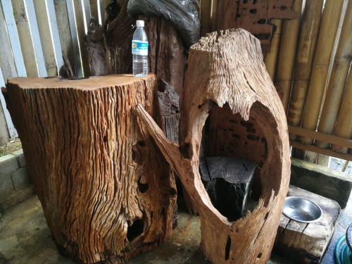

At Borneo they got one wood, kayu Belian right? They said Belian more durable than Cengal?True?
yes, but very hard to get new
nowadays, they just buy a whole Old wooden house and tear it down to harvest the belian timber
it's a pain in the ass to work with belian timber.

QUOTE(Angelic Layer @ Apr 4 2019, 12:27 PM)
Then what u need is decorative timber
not for structural purposes
so get lightweight wood with nice grains and use steel frame for structure

QUOTE(lucifah @ Apr 4 2019, 12:36 PM)
Most of the load are bear by steel as I understand in these construction, the wood are non load bearing, hard wood is difficult to get in long pieces and joints are more difficult to make and less consistent.
But can capture the feel of wooden house, the high ceiling, ventilation and draft is good enough, probably need some better solid wood like chenggal etc in some part, but substitute some chemically treated cheaper ones on others, and nice grain to look nicer still.
The one in the picture is the resort lucifah mentioned though, it is mostly concrete instead of wood I intended to.

QUOTE(msacras @ Apr 4 2019, 12:28 PM)
Infested with termites after 5 years. I had to striped all the timber flooring. Total repair ended almost RM 100k. Damn main contractor disappeared after completion.

QUOTE(acbc @ Apr 4 2019, 12:56 PM)
Was the wood problem, or ventilation problem underneath?
acbc
post Apr 4 2019, 01:04 PM
9,050 posts
QUOTE(Angelic Layer @ Apr 4 2019, 12:59 PM)
Main contractor skipped pest control treatment due to lack of sponsorship.
belian wood. v hard to get. is super tough wood. if u wan cantik cantik kind of wood. cant use it. structure can la. v hard to carve. and termite proof. so far have not seen any termintes at the my wood tho.

King of the wood is chengal lor, if I am not wrong
In Semenanjung yes.In Borneo is Belian,they said Belian are stronger and more durable than Cengal ..
Owh.. But chengal is very hard and durable d.. It is very expensive to even build them as dining table..
Yes,my mother in law house made almost entirely from cengal, 78 years old now and still strong as ever but Belian is more durable especially those fully matured woods (100 year old tree) they said can last 200-300 years ohmy.gif
why belian so hard to get? its a pretty featureless wood.. maybe people dont bother using it..thats all. biggrin.gif
TAZIO.N
post Apr 4 2019, 05:49 PM
171 posts
Joined: Oct 2010
QUOTE(ar188 @ Apr 4 2019, 05:26 PM)
what reason its called king of wood?
just because it can tahan? thats not enough criteria to be called king.
My friend also said it has some kind of mystic power idunnolol..Better ask Sarawakian who stay at long house.They will know better I think.Oh,this wood also don't float on the water I think.Anyway it's a special kind of wood, I can assure you that..
TAZIO.N
post Apr 4 2019, 05:52 PM
171 posts
Joined: Oct 2010
QUOTE(ar188 @ Apr 4 2019, 05:48 PM)
One of the reason is the tree itself is grow very slowly,fully matured only after 100 years old.The rest you can google lol...

mabaw
post Apr 5 2019, 03:51 PM
223 posts
Joined: Oct 2009
QUOTE(Angelic Layer @ Apr 5 2019, 01:03 AM)
Regardless, it seemed that belian, aka billian is a very good wood indeed.
Wikipedia: also known as ulin
If known as Ulin I would have some familiarity with them on some boats.
Was it of traditional or modern style?
Wooden frame?
Would like to hear how you do it.
kampung style
not true traditional
those tukang that are capable of building true traditional houses like without nail are very rare
will not be surprise if they asked 300 ringgit or more per day
QUOTE(ar188 @ Apr 4 2019, 06:19 PM)
so cool. show some pics. even if stalled , nice to look at the build pics.
potato quality
This post has been edited by mabaw: Apr 5 2019, 03:54 PM
TAZIO.N
post Apr 5 2019, 03:55 PM
171 posts
Joined: Oct 2010
QUOTE(mabaw @ Apr 5 2019, 03:51 PM)
kampung style
potato quality

mabaw
post Apr 5 2019, 09:52 PM
223 posts
Joined: Oct 2009
QUOTE(ar188 @ Apr 5 2019, 09:33 PM)
yeah i have two of them working on my projects now. really hard core when it comes to wood. biggrin.gif
how much u paid for yours?
mine
biasa - biasa one - rm100 per day
ketua/chief/ - rm 130.

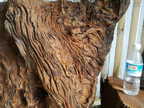

lucky8six
post Apr 5 2019, 10:29 PM
47 posts
Joined: Oct 2006
QUOTE(TAZIO.N @ Apr 4 2019, 12:23 PM)
Both superb durable and no study research to prove which is tougher and durable. But if i were to pick. Belian Wood for the win easily. Belian wood is crowned as borneo king of the wood (ironwood). All panjang Dayak house structure made with belian woods still standing strong today that last few generations. Fun fact It takes 120 years to grow 30cm diameter.
https://www.frim.gov.my/colour-of-frim/eusi.../cv0/ab88/pt357
Owning a piece of Belian wood (Long table) is consider very luxury in Sarawak. Belian = Berlian = Diamond
Wanna show some of my collection Belian Wood. Owning belian wood mean last forever. Above piece (left) is believed nearly 200 years old belian wood. It was excavate under ground earth. That's why the grain is deep. Belian wood is getting scarcity nowdays. Usually pass down by older generation.
This post has been edited by lucky8six: Apr 5 2019, 10:34 PM
SUSAngelic Layer
post Apr 5 2019, 10:41 PM
91 posts
kampung style
potato quality
Very nice, it could be partially move in already, it would be very worthwhile if it can be completed.
RM300 per days is actually very reasonable, cheap even given 20 days working month, you can't get such skills for 6k per month, which state it was in?
QUOTE(mabaw @ Apr 5 2019, 09:52 PM)
mine
Looking at the picture, such work is good enough as well, very worthwhile.
How much does the wood and project cost so far?
QUOTE(lucky8six @ Apr 5 2019, 10:29 PM)
Yeah, no point picking who is the king as both is good enough.
It would be nicer if the wood can be made into something more functional, if even thinning it and hang it as decoration, set a light coming out of it as a lamp stand is wonderful as well.
mabaw
post Apr 5 2019, 11:46 PM
223 posts
Joined: Oct 2009
kedah
for the house only we have spent close to 200k. majority are on the secondhand hardwood, and those ukiran ukiran thing. but those is new made from low quality wood bought in southern thai. majority of the left side in the pic were old house that came together with the land. we jack it up and fixed what needed.

Princess_Alicia
post Apr 6 2019, 12:01 AM
98 posts
Joined: Jun 2015
Palmyra House
This is what I called modern interpretation of timber house
SUSAngelic Layer
post Apr 6 2019, 05:58 AM
91 posts
QUOTE(mabaw @ Apr 5 2019, 11:46 PM)
kedah
I consider the price very worthwhile, even maybe concrete house is cheaper still in comparison in Kedah, it was something that maybe people wouldn't do in not too distant future.
QUOTE(Princess_Alicia @ Apr 6 2019, 12:01 AM)
Palmyra House
This is closer to what I am thinking to do, though I am thinking of incorporate local features like pier foundation with steel beams, as it offers benefit for a non permanent house, and ventilation of course.
I like the way modern designs are brighter where traditional wooden house is quite dark, due to the natural color and hue of the wood itself.
