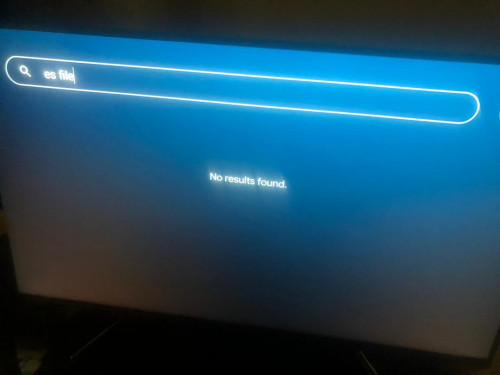

Bro can you teach me how to install myiptv4k to my Sony AndroidTV? I tried the all the download link i found but always same message (refer attached pic)
https://pictr.com/images/2020/03/18/5ynCwG.md.jpg
Tried using USB Drive but also dunno how to open the usb. Tried download ES File Explore also cannot find in the this AndroidTV's Google Play (second pic)

Use laptop to download all the apk file and transfer to usb drive
for ES File Explorer File Manager installation, you need to rename the file to a shorter name, maybe the file name too long and the system cannot recognize the file
do the same for the myiptv4k file as well

Thanks! Which application do i use to open the apk file in the AndroidTV once i put the usb drive?
