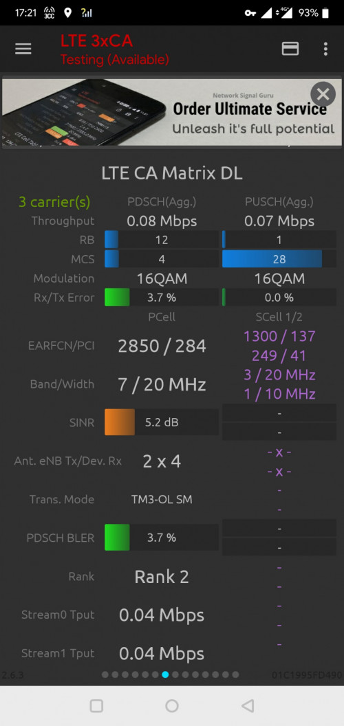

can go for OnePlus. I jumped from Xiaomi to Oneplus and own a Oneplus 6 now, able to get 3CA (1+3+7) on Maxis, and 3+7+8 on Digi, even better, it support Digi VoLTE and VoWifi (but need little tweak to activate)
How do you check this? What software on the phone?

QUOTE(wild_card_my @ Jan 17 2019, 10:22 PM)
Network signal guru (need root)
And you will see something like this
wild_card_my
post Jan 17 2019, 11:33 PM
6,562 posts
Thank you! You've helped a lot!
