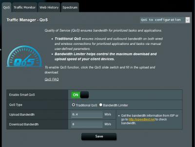

TM guy told me, only way to fix temporary is limit both Download and Upload,
for example, DSL Line Rate 10240kbps DL, 640kbps UP
half these speed in Bandwidth Limiter to, 5120kbps DL, 320kbps UP
which mean, give more buffer for ATM stream
problem is, how do I claim rebate for speed cut?
asking to downgrade account to 4mbps, TM said will lead DSL Line Rate limit to 5120kbps DL, 512kbps UP.
10mbps port only for 8mbps streamyx...
damn it...

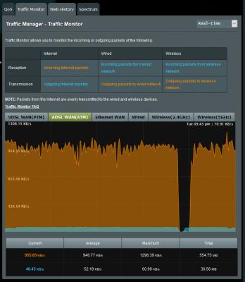

disconnect time, just perfect
QoS wont help...
Time when PPPoE disconnect, I just pay the bill
IP Address, Old and New, TM will have this record, I not lying !
