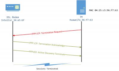

It just happen,
Every time I use 8mbps available bandwidth, PPP LCP from TM send a Disconnect Request, and PPP Client had to accept, I thinking to exploit PPP by ignore Disconnect request, stay connected all the time
Dont believe Asus Logging, I have Wireshark results:
To visualise:
YES, DSL is stable 100%
see this video...
Issue since 15-Oct-2018

The script I use:
CODE
#!/bin/bash
# filename: stress.sh
# call: bash stress.sh
# os: vyos 1.2.0
killall -9 iperf 2> /dev/null
echo "[INFO]: Hello!"
while :
do
sleep 10s
if ip link show | grep -q pppoe0; then
 if pidof iperf > /dev/null; then
  echo "[INFO]: pppoe0 is up and iperf is running"
  continue
 else
  echo "[INFO]: connection restored! waiting..."
  sleep 30s
  echo "[$(date +'%F %T')]: pppoe0 inet is $(ip addr | grep 'pppoe0' | tail -n1 | awk '{print $2}')" >> pppoe0.inet.log
  echo "[INFO]: iperf is executing..."
  iperf -c server.vultr.vps -p 8080 -t 600 -d -P 3 &
 fi
else
 echo "[WARN]: pppoe0 is down!"
fi
done
Since they monitor my PPPoE dial activity, I do this when no one use internet

TSAnime4000
post Jan 3 2019, 02:32 PM
2,399 posts
Joined: Jul 2009
From: /dev/null
QUOTE(miloaisdino @ Jan 3 2019, 01:47 PM)
good job taking all their ip addresses haha
hahaha yeah, TM 04:25:c5:96:f7:63 (Huawei Telekom) keep rejecting my internet sessions
QUOTE(JohnLai @ Jan 3 2019, 02:16 PM)
Just asking.....have you ever change the streamyx login password before?
Yes, I change many time
SilentVampire
post Jan 3 2019, 02:41 PM
Networking Enthusiast
5,714 posts
Joined: Mar 2007
That is crazy. You are being disconnected and reconnected multiple times. Stupid question, but did you ever try using another modem router, and another cable? Just remove everything on your current network and use a different modem router, and a different cable, and see if that changes things.
miloaisdino
post Jan 3 2019, 02:46 PM
1,418 posts
Joined: Jul 2015
how about find a way to force them to switch port for u?
