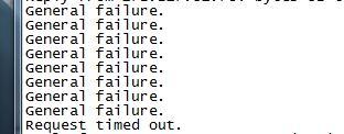

# Maxis fiber internet connection keep on disconnected randomly for no reason.
# this internet dc issue can be notice on both WIFI and LAN connected device.
# when change back to unifi router and modem, all is good.
# tried every thing to solve maxis random dc issue, no result.
# suspect ISP (maxis) or their provided hardware is the root cause.
Long ver:
hi all ,anyone experiencing random internet lost when using Maxis Fiber broadband ?
i switch from unifi 30m to maxis 30m, initially some hiccups happen but was fixed after calling the Maxis tech (thanks maxis tech guys). but then i notice the internet is not stable at all since it will lost internet randomly.
this is frustrating since even thou it happen randomly, but it happen in a very consistent fasion.
this kind of internet lost is very noticeable, especially during online game session. the entire game session will lost when this happen, and for most cases not able to reconnect.
same thing when browsing website. when click to open a site, you will notice the site is not loading at all, and at that moment, when check the task bar at the lower right, you will notice the red "X" at the network icon which indicate the internet is lost. the internet will recover after a few second.
initially suspect the LAN cable or Network adapter is at fault, but this is not the case for my side because when the internet is lost, it happen at both devices that connect to WIFI and LAN device. i know the internet is lost at the device that connect to wifi as well cuz i install app to do ping at my android device.
when the internet is lost, both LAN and WIFI connected device will get ping error "General failure." or "Request timed out.", this will happen for like a few second, then the internet will be back again.
This never happen when using Unifi provided hardware.
true enough, when revert back to Unifi hardware, all is good and not a single "General failure" or time out error from the ping result (LAN connected PC). WiFi wise very little packet lost, way lesser when compare to the time connected to Maxis. hence the entire issue pointing back to either the ISP (Maxis) which i have no idea what happen over there, or their provided hardware (modem or router) have some kind of serious issue.
i fully aware that my area's intra is not that great(old flat), hence im not even expecting full 30mbps speed. But heck, constant internet disconnect is a big no no for me, even if Im not using the internet for gaming.
anyone have any kind of solution on this ? i seriously doubt change to a better router will help.
do let me know if any of you have solution for this. thanks in advance.
i did call the Maxis SC and get some tech support for this but their solution not really solving the internet lost issue. will keep this maxis for another few day for testing purpose, mostly might end up returning it due to the constant random internet lost, which is a shame since Maxis offer better download and upload speed at a lower price.

Since the Unifi hardware works and the Maxis one gave this fault, just call Maxis to troubleshoot. Most likely their hardware problem.

Happened to me roughly 2 years ago, DC for several seconds only but very consistent. Like every 15 to 20 minutes once.
Changed the Maxis's default modem to my own Asus one. Problem gone.

For me, no need deeper diagnostic. It obviously WiFi router. You can easily confirm by connecting direct to the BTU or/and WiFi LAN socket using cable. The wireless side if the router is usually the problematic one.

to both of you, THANK YOU SO MUCH!
i really glad i took you two's advice and go purchase a new router myself, cuz this router actually solve the intermittent internet disconnect issue.
went to lowyat this morning and been ping to gateway and google.com until now, heck, no more those multiple line of request time out or general failure !!!

QUOTE(watashigundamu @ Aug 30 2018, 10:54 PM)
its like, 1000 times better than the maxis provided router. no kidding !!
for some one that been with Unifi provided hardware for 6 freaking years , I'm now a firm believer on getting a better network hardware = better experience , no more doubt.
i bought an asus ac1300 ac58u.
when setting up, i notice at the asus router setting there mention "port 3" = VOIP, weird cuz the sales person say this router no VOIP function.
so out of curious, i connect the Maxis router to asus router at lan port 3 . so now, the asus router that does not comes with phone port can use maxis provided wireless phone to receive and makes call , through that Maxis router !
seriously did not expect that feature !!!
and the 1st thing this sweet sweet router did when connected to the internet is download and update its firmware ! so smart !!!  totally no idea a router is capable of doing such !!!
not yet into the mesh network thou, but that some how sounds very interesting !!
YEAH !!! no freaking way !!!
The Unifi ready is just the one that can support VLAN. The Asus router and selection in menu to set to Unifi setting thus easy for customer. Maybe no Maxis setting, but if you know the setting, you can still manually configure but yet need to know all the setting parameters sad.gif
facelol

yo TS, wat model of asus router u changed to?
my maxis fibre 30mbps also keep disconnecting. always give ppl diu me when i play dota
so frustrating

QUOTE(facelol @ Mar 12 2019, 02:18 PM)
so frustrating
This is the reason why initially I tot of switching to it due to price but end up managed to hold it back for good reasons.
